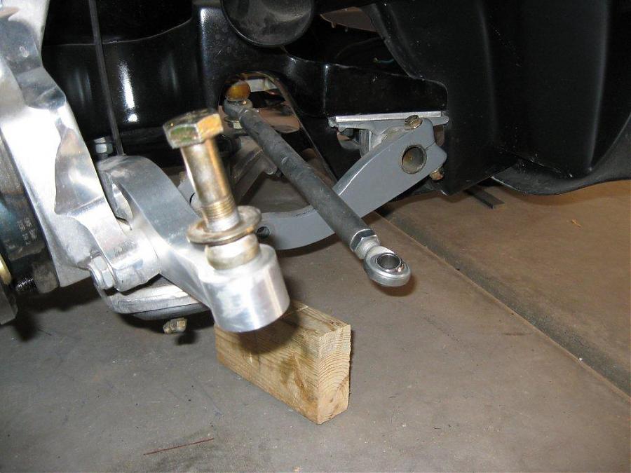

Originally Posted by Bill71 View Post
I'm looking for anyone's experience with splined front sway bars. I have a 2nd gen Camaro and would love to see pics and specifications. My car is being built for road course use. Not sure how to determine bar length. Also, the Speedway mounts look pretty weak compared to others I've seen.
Here is a Speedway Engineering bar with their "monoball" bearings -- metal-to-metal, so no give. Rough for the street. As Vince said, the arms are huge. I cut these down for my application, but a spot-face mill could be used to take a lot of meat out without sacrificng strength.
Pappy
Old 12-14-2013, 09:53 PM
Vince@Meanstreets's Avatar
Posts: 5,532
Thanks: 13
Thanked 20 Times in 13 Posts
Nice Papp, you guys know of any machine shops that can broach a piece of mild steel. Might have to try and make my own arms. Just need someone to cut a hole and spline it to the sway bar.
