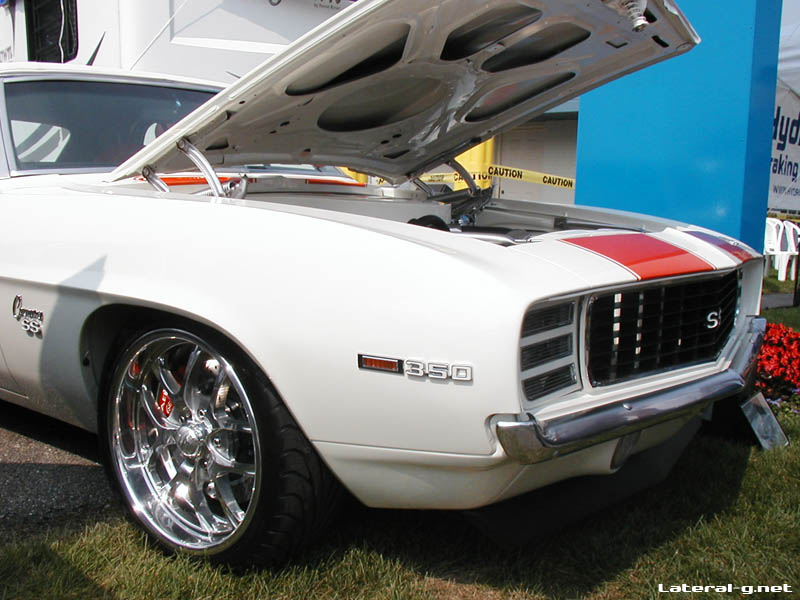

Yes, The wheels on my car are Centerline Lazers. They are every similar to a Z06 wheel, Soft Lip, inside mounted valve stem, very nice build quality. Centerline may build you a set wider if you requested it.
Oh, and its Trush, Thrush is a Muffler!
Pics if you haven't seen these wheels before....
