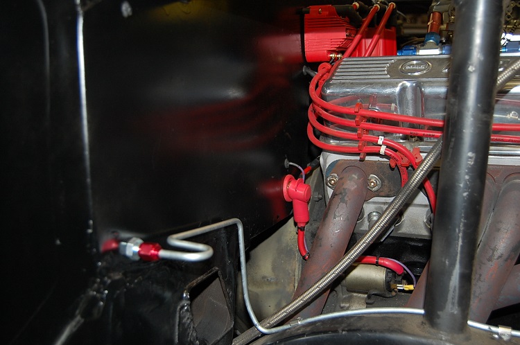

I like to use the Moroso bulkheads too.

I have a question why is the negative pass through insulated like the positive ? If it wasn't wouldn't it be another grounding point? Or am I missing something??

For grounds I just use a 3/8" bolt. From the battery to the frame, crossmember to the trans, two engine to frame.
I agree, its a waste.
