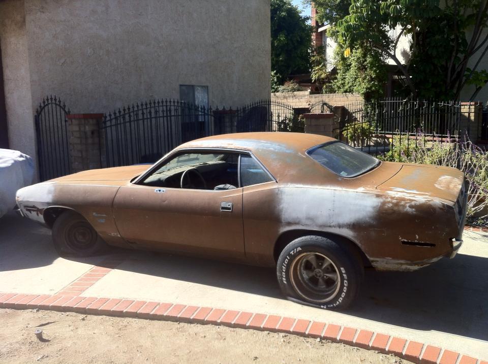

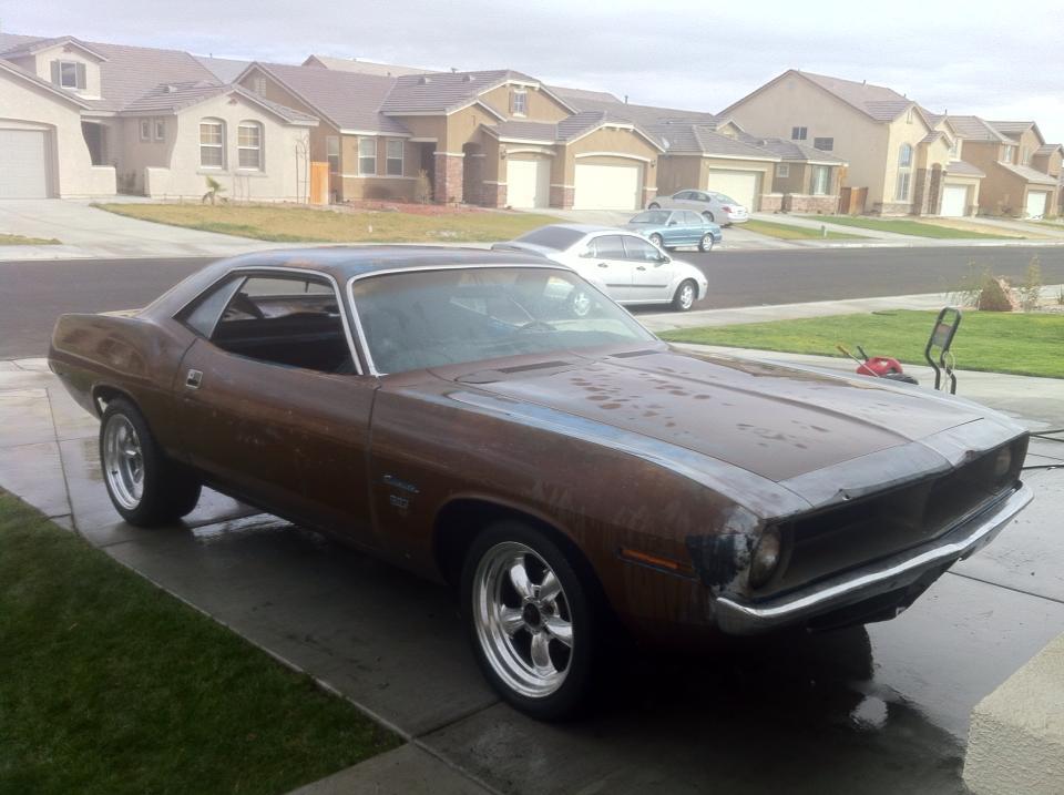

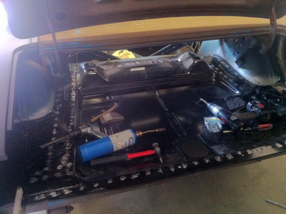

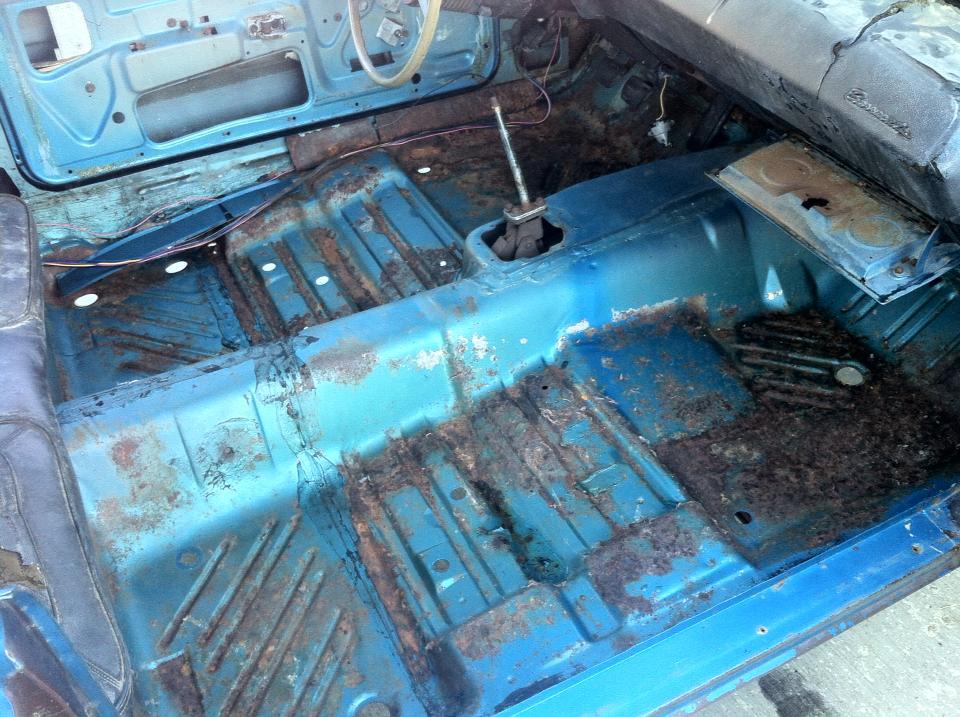

ok well so ive done my intro and had a bit of time talk more about the car. so california car bought about 2 years ago slant 6 car with 3 speed manual. so far ive replaced the quaters, roof trunk rear tail panel, front floor board, and and made some of my own panels. the plan to have a mild street/autox, and roadrace car with and be able to daily drive it.

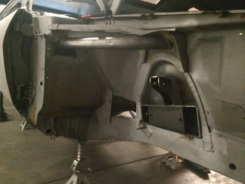

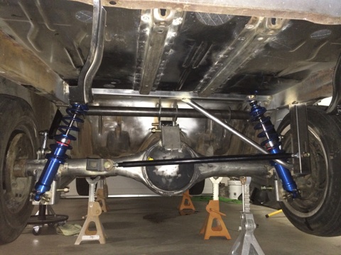

more pics the whole back half mocked up, and the xv stuff tacked in waited till i got the c25 gas for my welder just got that last week. enjoy

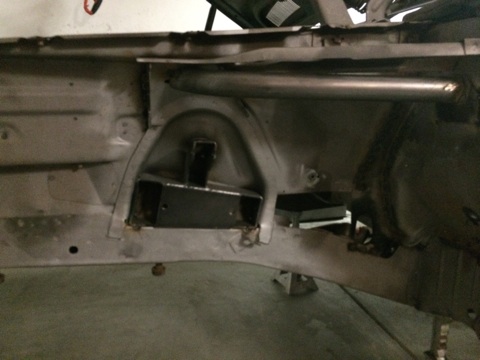

i felt the exact same way for awhile, but couldnt really grasp on but the RMS set up or the AIR BAR from AirRide neither are bad parts just dont like the 4 link set up, so im glad i waited it out just finished welding up the front upper control arm buckets and stiffing stuff over the weekend suspension is in california just waiting to see when they want to schedule delivery.

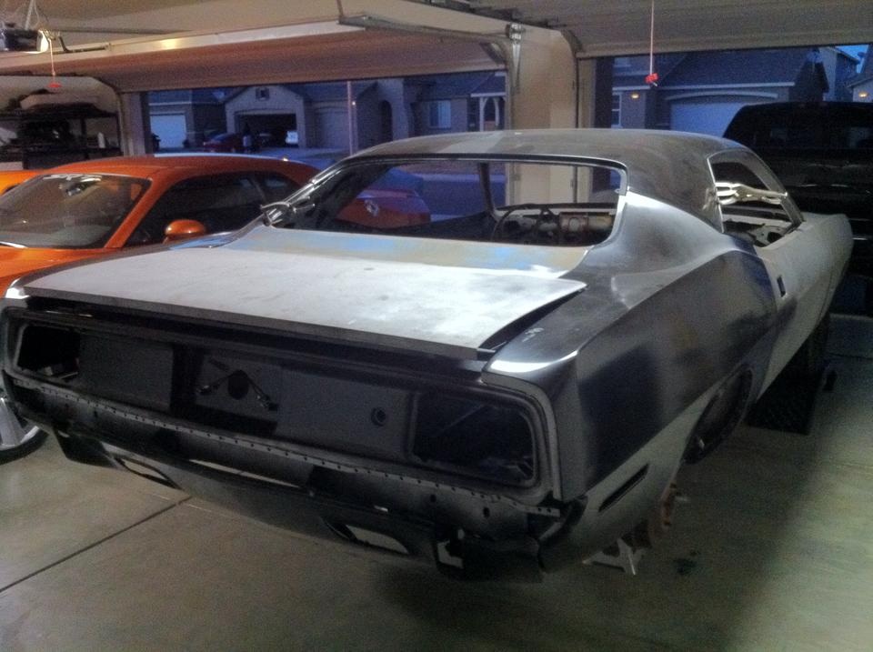

Default Update 20150201

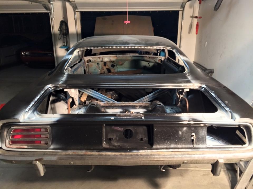

Xv level 2 suspension install complete! Also finished up the rear body work of the car .
James

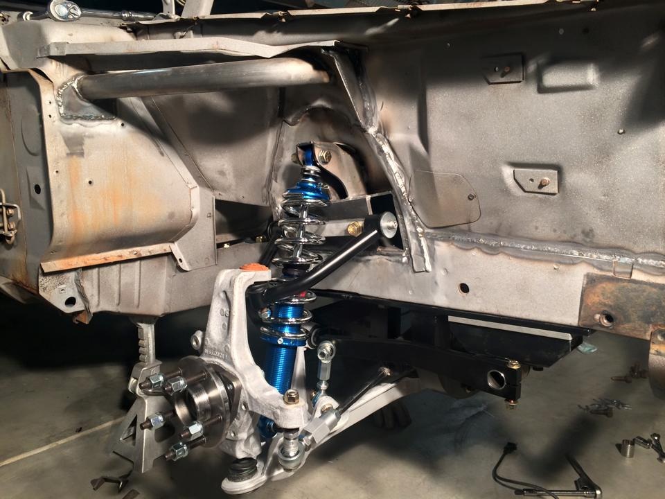

Another shot

Looks good. A couple of questions. Does the XV have both camber and caster adjustment? Do you know what the hub to hub (face to face) width is? I originally bought my Fikse wheels set up for the RMS width and just wondering how close it is.
Thanks, Wes
Old 02-02-2015, 10:51 PM
b5devilfish b5devilfish is offline
Join Date: Dec 2014
Posts: 12
Thanks, Wes
Wes,
camber caster, and hub to hub looks like 62 3/4 that's also sprung measurement I don't know if that will change at ride height I think it would? If your gunna spend the money I think going the xv set up is better in the long run just IMO. I just haven't seen the rms hit a road course, just autocross.
