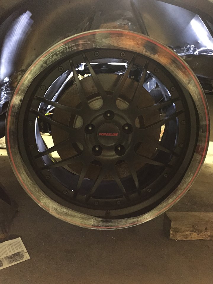

Greetings,
If you check my build thread, you'd see that we put a 5th Gen Camaro IRS into the back of my 73 Camaro.
So far, we used the Camaro knuckles with a Z06 unit bearing. The Camaro Brembo rotor fits loosely over the wheel studs, but not the unit bearing register.
Before I open up the Camaro rotors on a lathe, is there a stock rotor that will fit Z06 pattern, the Camaro SS in rotor hat e-brake shoes and Brembo SS caliper?
I am thinking Z06 rotor, but it's an expensive experiment, since I can't return the rotor if I fit it up.
If a vendor knows the info, happy to buy the rotor from y'all.

as it turns out, I can use the 5th gen Camaro hub with the Corvette based wheels I have.

I can measure the c5 rotor that I have at the shop in a bit.
I appreciate it. Not needed though. I found that the Camaro hub fits, so I can use the Camaro rotors with the Brembo's I have.
I may do Brembo's in the front, too. Sadly, I have Baer there now.
That's a Camaro hub, with Camaro rotor and a Corvette based Forgeline.
