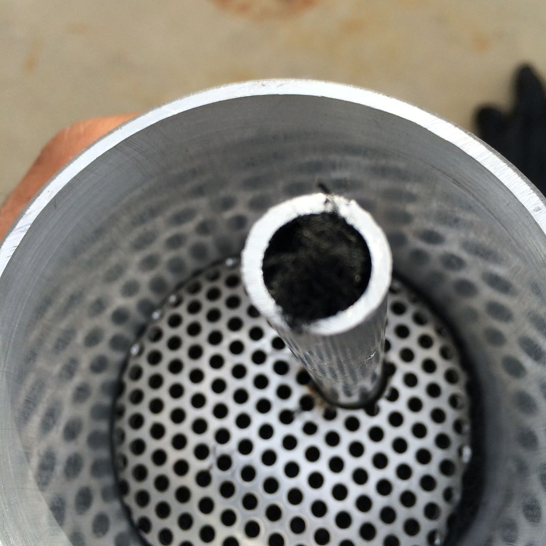

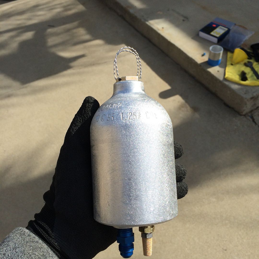

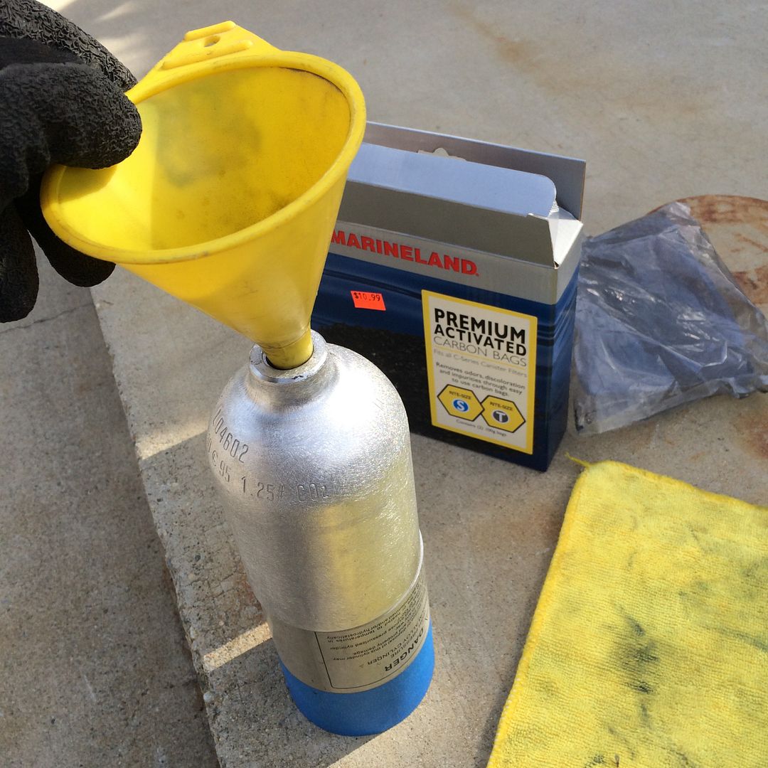

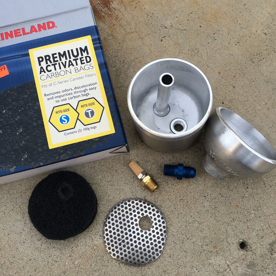

Needed to vent tank and this is how I did it.
Carbon filter material
Some activated carbon from local pet shop
Co2 cilynder
Micro filter
2x 1/4" bungs
Aluminum tubing ( placed some carbon mesh inside ) to prevent clogs
Line going to tank is isolated from loose carbon.
Access on top to replace carbon if needed
Will put a safety valve on the line

Very cool. I was going to build myself a couple. Did you cut the C02 tank in two pieces and weld it back together?

Yes it got cut and shortened by 4"
