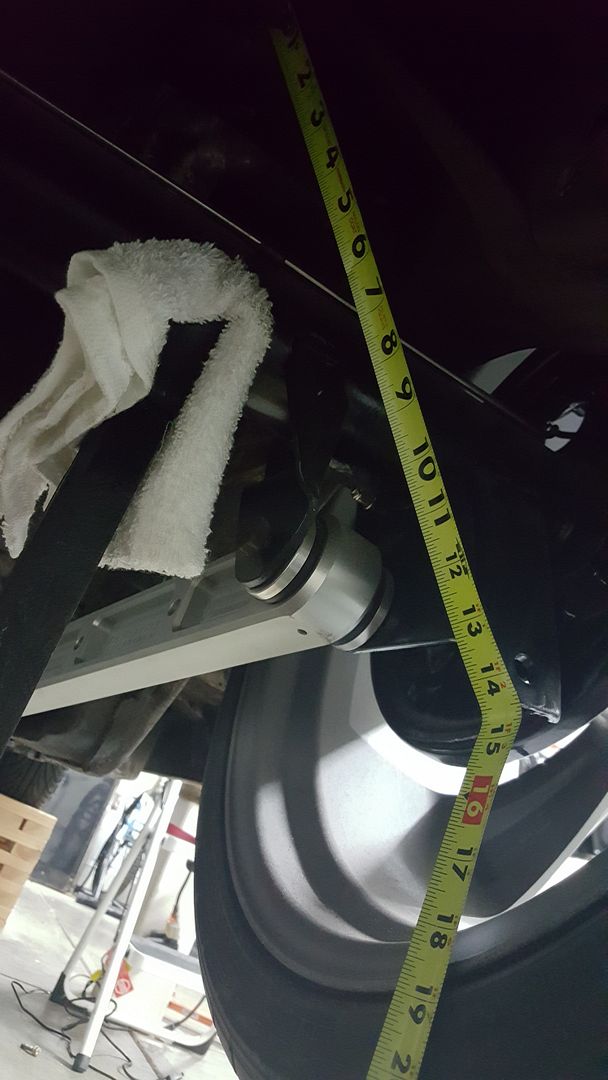

I'm looking into rear coil-over kits for my 64. I like the Ridetech kit but can't seem to find the extended and collapsed dimensions on the shocks. Does anyone know what they are? Here's a photo of my suspension sitting on the bump stops. I want it as low as possible and I'm afraid the shocks might be to long. Any thoughts?

The coilover kit is designed to lower the car right around 2" compared to factory driving height. With our shock brackets, the ride height measurement from mount to mount is 14"-14.5". We use our 5.2" stroke shocks in the rear of these cars, here are the exact dimensions on it:
Compressed: 11.63"
Ride height: 14.5"
Extended: 16.42"
Our bracket drops the shock mount down farther, so the longer shock can be used for more travel, but still keep the lowered driving height.

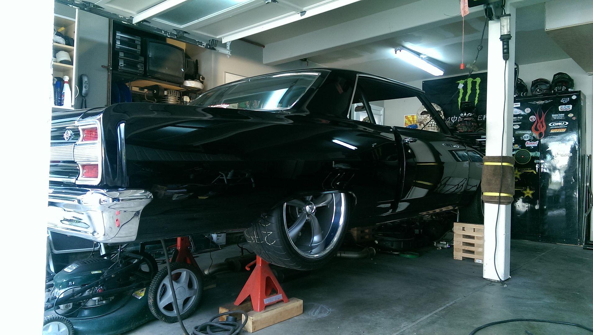

This is roughly the ride height I want to go. It'll have to be a little higher but as close to this as I can get
