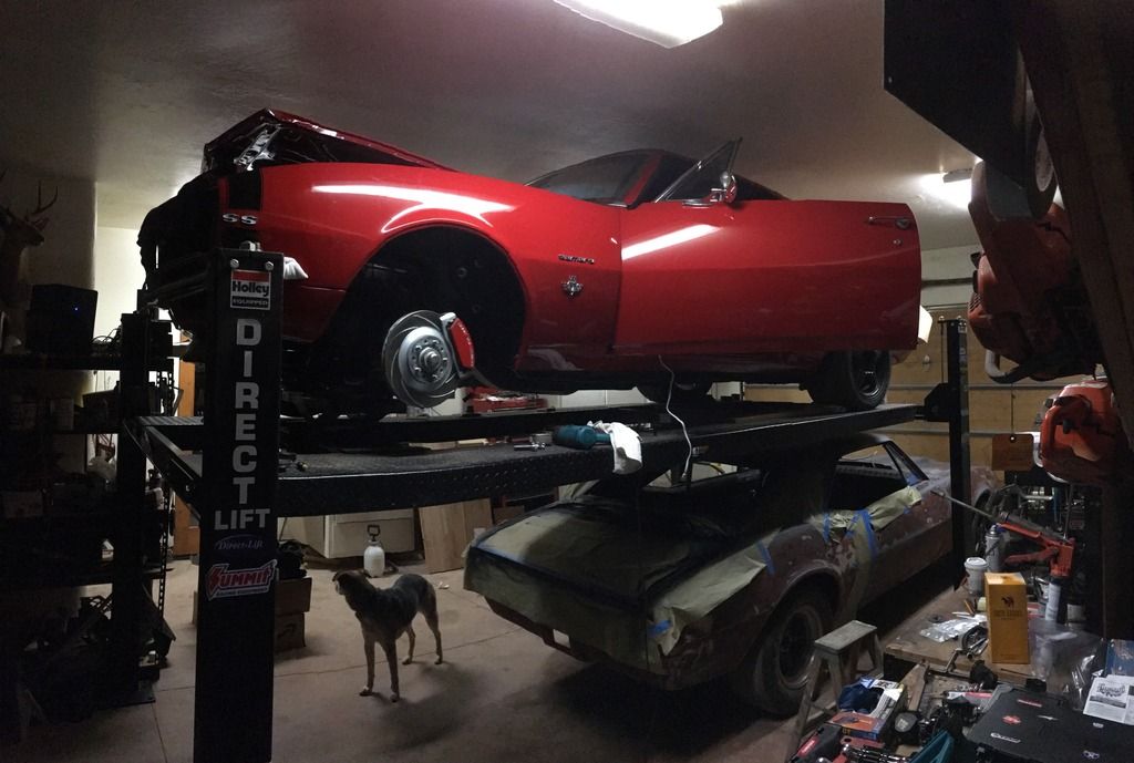

My ceiling is at 10'1... Can get it up descently well, still need to crouch just a little bit, but am able to get good mobility around the underside.
And still allows me to park another one below.
