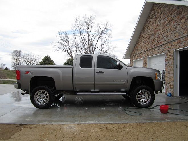

Here are my two trucks. Both are 6 inch rough country lift kits with 35 inch Tires. My trucks were pavement princesses and the lifts were perfect for that. Both trucks had 3.73 gears so I only lost about 1-2 MPG. I also did not notice a huge difference in the ride quality. I have had trucks with 4 inch lift kits but I was never happy with that little of a lift. I think 6 inch is perfect. Both sets of wheels had 4.5 inch backspacing. I lift every truck I get.

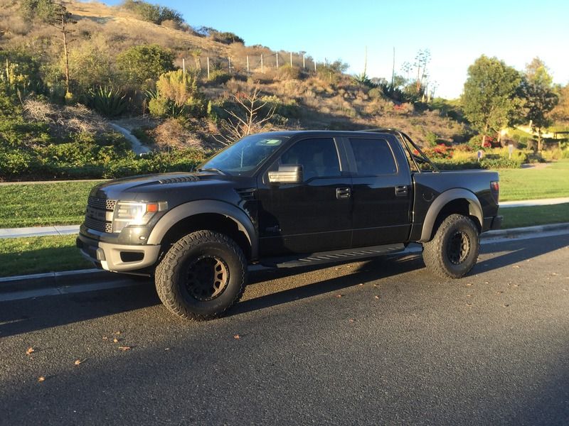

2013 Ford Raptor:
Stock suspension, front coilovers adjusted to mid-perch.
37x12.50x17" BFG AT KO2's.
17x8.5" Method NV's with 0 backspace.
Extremely minor trimming on the inner fender and done.

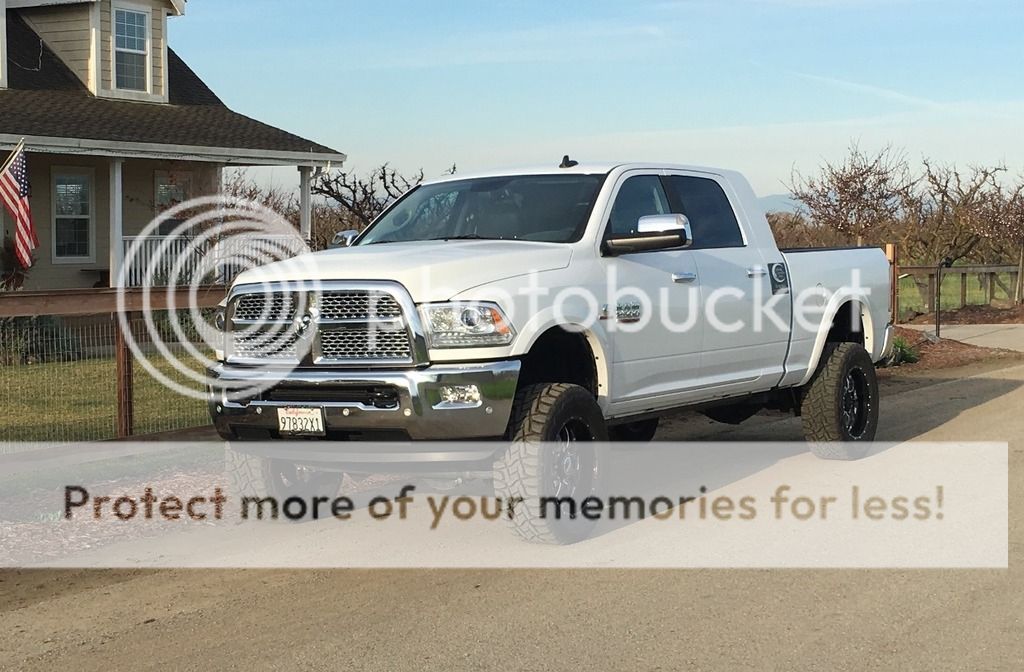

2016 Diesel Mega Cab
BDS 4link 4" on 35's
Fox Shocks
BMF Novokane
