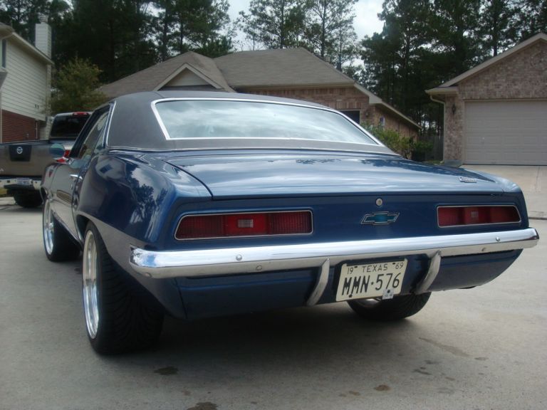

the issue im having is that BFG doesnt sell KDWs anymore. Im running 275/35/19s 10" tire. Its lowered 3" with DSE lowering springs.
A friend of mine has a pair of 285/35/19s for sale, will they fit? or is 275 the largest size I can run without being mini tubbed.
Any other tire options if those 285s are to big
