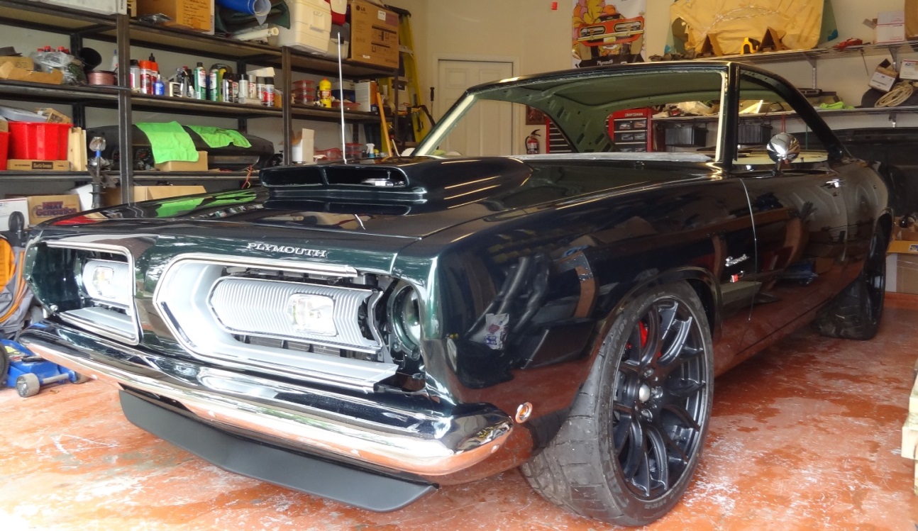

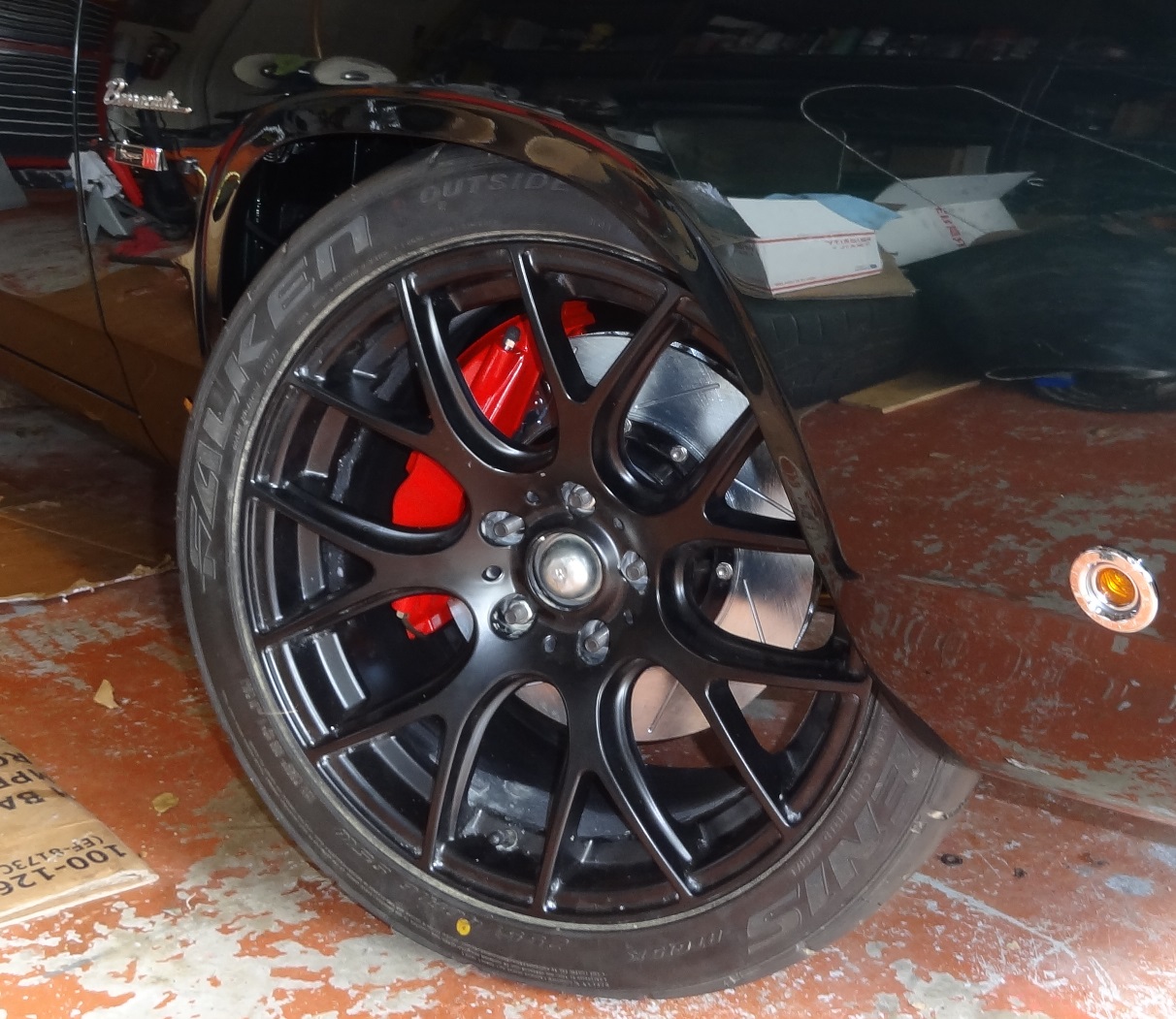

Here are mine. Front is 18x9, rear is 18x10. I have enough room to run 18x10 front with a 275/35-18 and 19x12 rear with a 325/30-19. My spindle is the same as yours if you have disk brakes. I am not familiar enough with E bodies to know exact fitments, if you are in North Texas I could help you out.

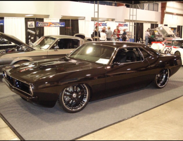

Sorry I should have but a size. It is still a stock bolt pattern any I would like to get 20" wheels front and back or 19-20". I am trying to find a 20x12 or something along that size. I am going to mini tub it but I would like to find wheels before I cut the body. I attached a pic of what I'm kinda looking for
