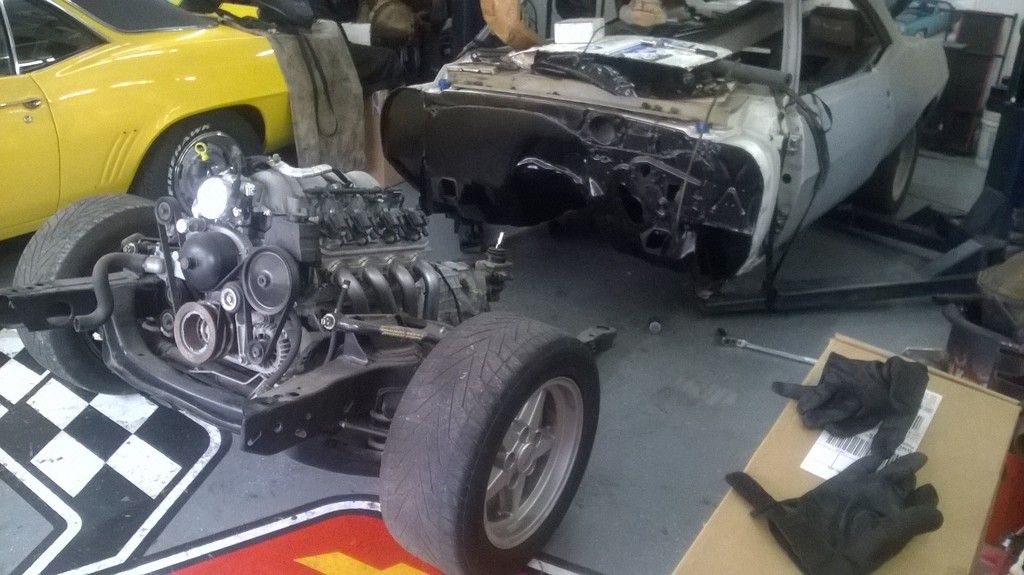

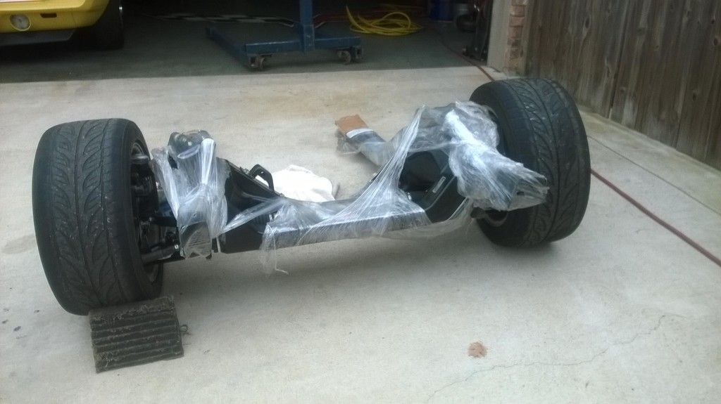

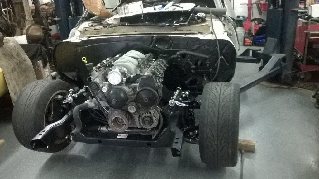

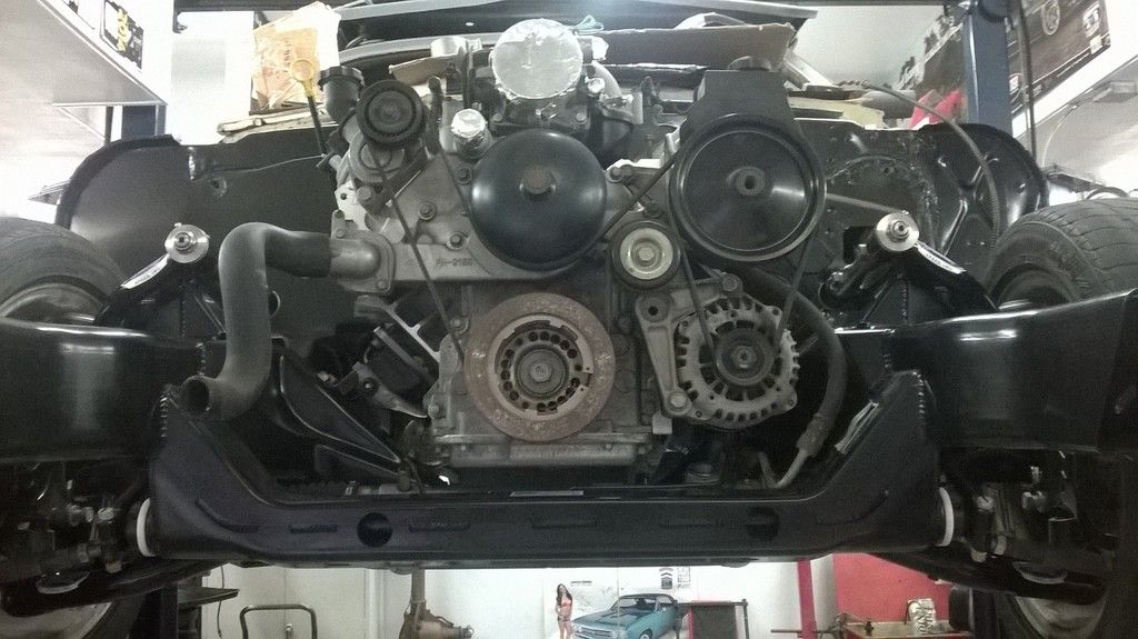

thanks Don and Tim
I was looking at work today and found the dreaded answer Fbody comp mount will not work, I did see Holley and Kwik and dirty dingo I kind of like the Holley stuff so far - any pics of that bracket and comp installed?
BTW on a weird side not LAT-G is blocked at work and the other PT board isnt but I really dont like the setup they have for threads
Out with the old
And In with the New!

Kwik makes a low mount bracket for the small Sanden compressor but it is for LSA/Corvette accessories. For F body accessories your only option is the Alan Grove bracket but it won't fit the DSE sub. The Art Morrison sub is the only one I am aware of that will accommodate the stock F body compressor or the Alan Grove F body mount.
Rich, I put the Holley bracket in my wife's 69 vert if you want to take a look at one installed. It is the Corvette spacing version.
