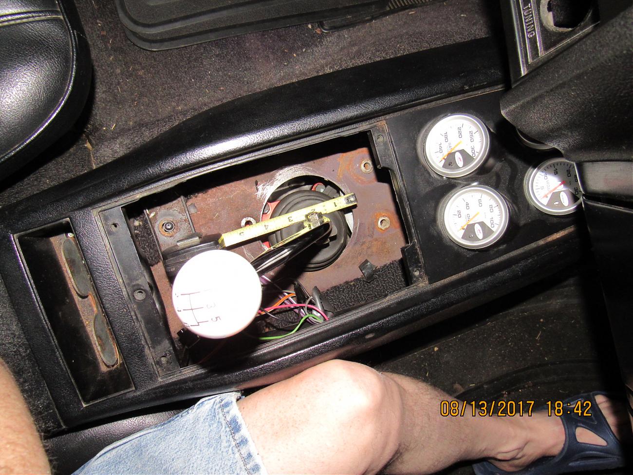

Here's my install - TKO600, I haven't bolted the trans mount yet thus why it is not centered. I used a 4" metal holesaw.

You can probably get away with a slightly smaller hole in the tunnel than Greg's pics but this is one of those things where you don't need to be too precise. Just need the clearance Clarence.

Thx for the reply. I was curious what other guys did. I could even just cut out the exact size of the shifter plate (for lack of better description). Its almost a rectangular shape.
