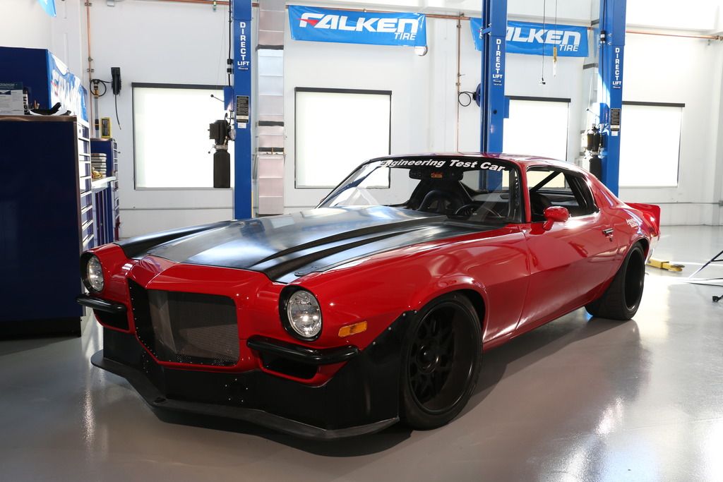

Here is the Carbon Kustoms hood on #ProjectRedDawn. The fitment was great and it is pretty darn sturdy. We've been 150+ mph with it on the Fontana Roval. Gopro video shows it held its shape the whole time.
If anyone is interested in the poly carbonate windshield it is For Sale.
I'm interested in the front air dam / splitter. Is this a one off or is it available from someone ?
Thanks
I am not sure who made that one but Randy at D&Z Customs makes one very similar and it can be bought. Many top 2nd gen builds have used it.
