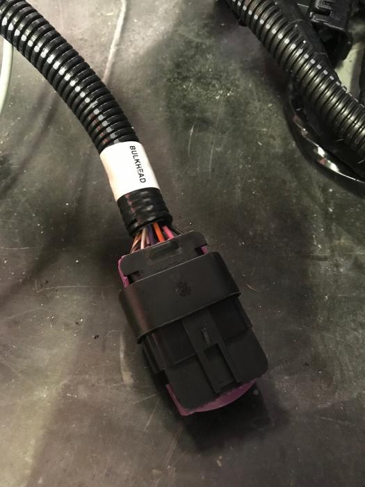

I have a dumb question but her it goes where does the “Bulkhead” connector plug into?

Nothing unless you want to use it for instrumentation outputs. In the instructions there is a table of the outputs available to use.

Bulkhead connector also connects to the auto transmission controller if you have one.

I pulled ignition and speedometer off of it.

Pinout & part numbers in attached PDF.

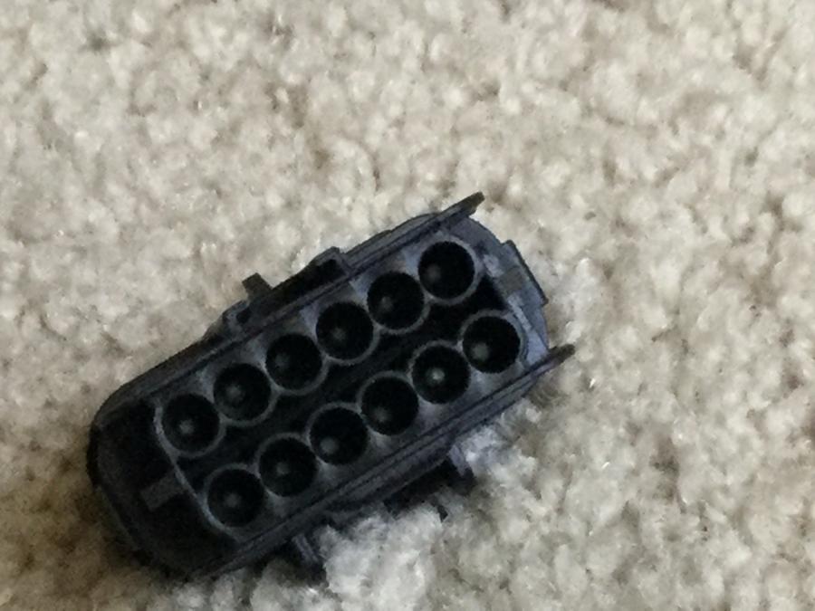

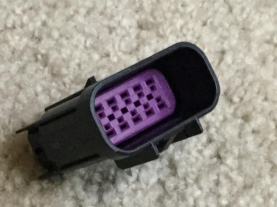

For those that have used the bulkhead what’s the best way to pin it and what type pin does it use male or female etc.. ?
Not sure how the purple connector comes apart... figured I would ask before I break it ...lol.
