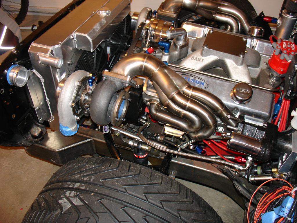

Got my TT headers from Nelson Racing Engines. They are 321 stainless and the flanges and mounts are a half inch thick. They are silcon bronze welded and TIG'd on the outside AND inside. They have 25 degree merge collectors and 1 3/4 primary tubes and are dead sexy.

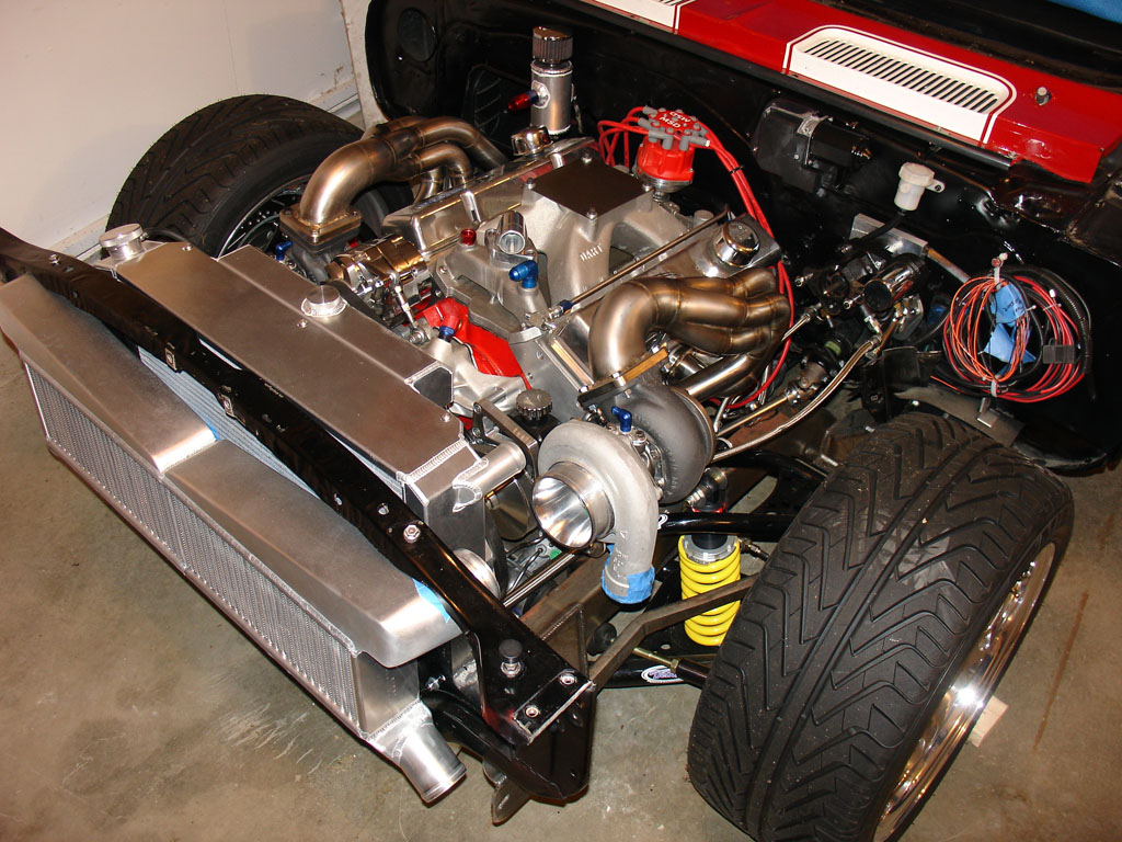

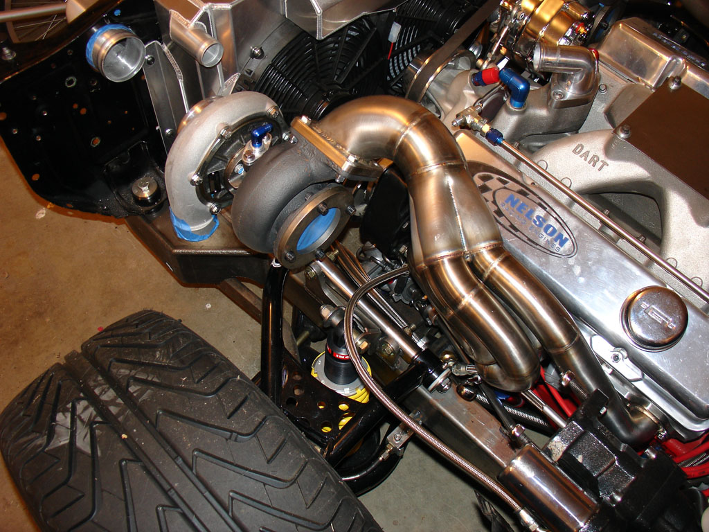

Here are some photos i took when we were mocking them up i have a very nice fixture for this header.It fits The ac nicely
