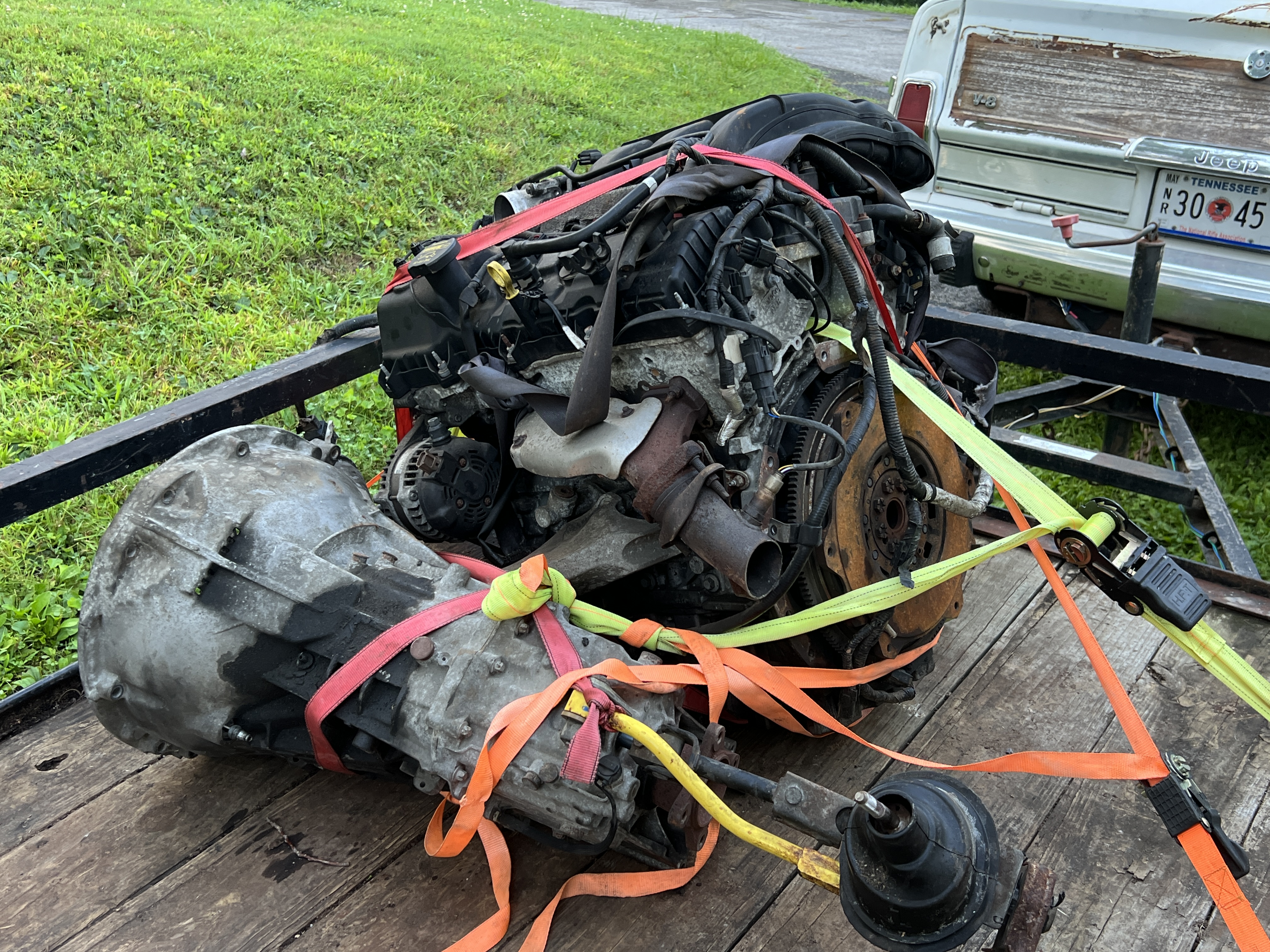

Went for a ride with my wife and came home with a Duratec 3.7 and 6-speed from a 2012 Mustang.
