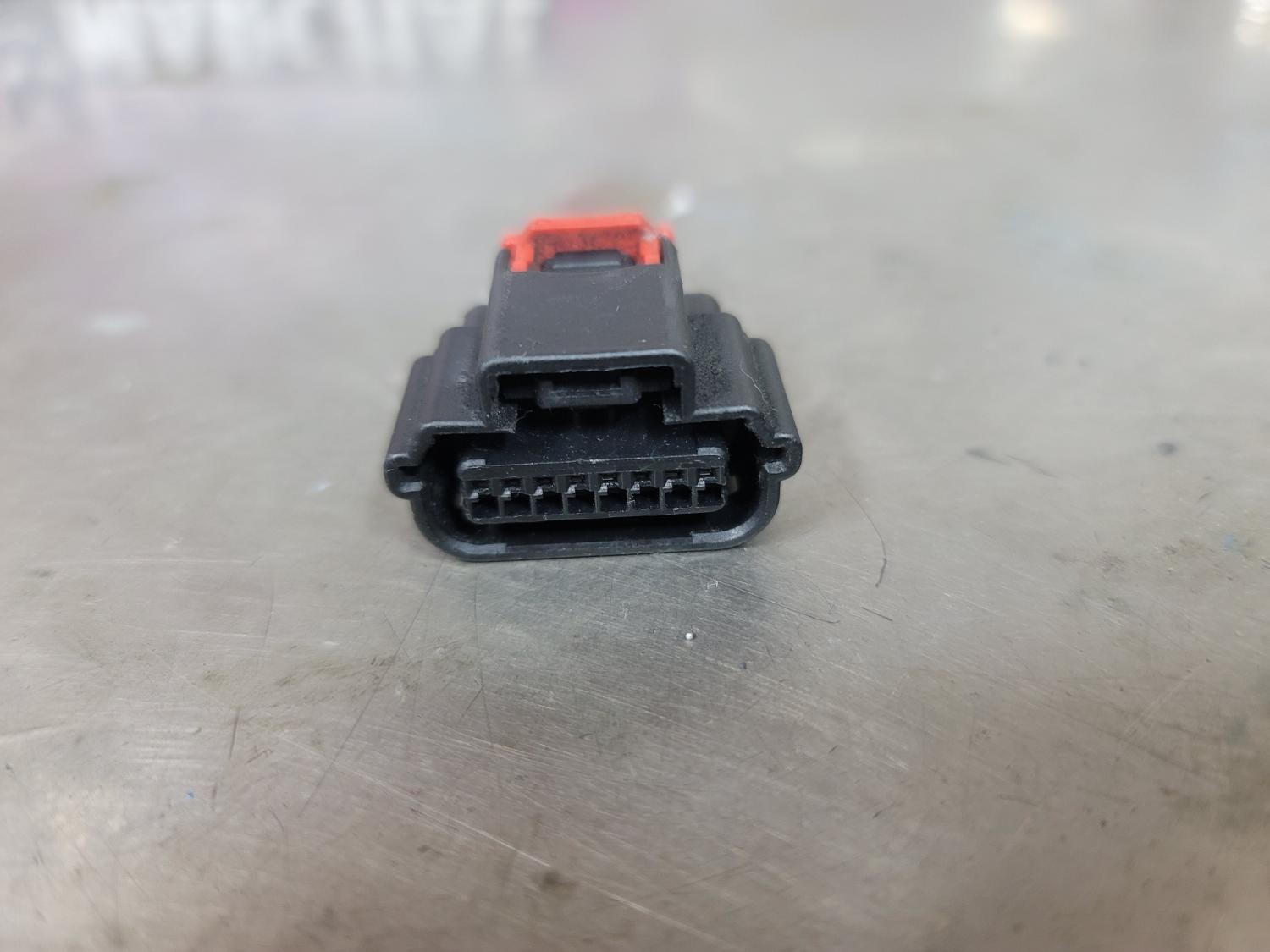

Had idler pulley seize on my 2019 LT4 which took out the the two drive belts which pulled the wiring out of the Mass air flow plug. What are my options? Looking at the plug it is not obvious how to reterminate the wires. I see extender harnesses which I could splice in but not ideal.

Thx, but mine has 7 wires. Connector with a red locking tab. I know the coloured wire positions. Have figured out how to pull off the connector retainer but not how to get the individual wire pins out.Name:  20230813_080738.jpg

https://static.speedwaymotors.com/pdf/425571101.pdf

Thx for that. Had not thought it was anything but a crimp connector.

Thx, but mine has 7 wires. Connector with a red locking tab. I know the coloured wire positions. Have figured out how to pull off the connector retainer but not how to get the individual wire pins out.Attachment 80495
That is a Molex connector, not Metripack...
https://www.bmotorsports.com/shop/pr...oducts_id/3427
