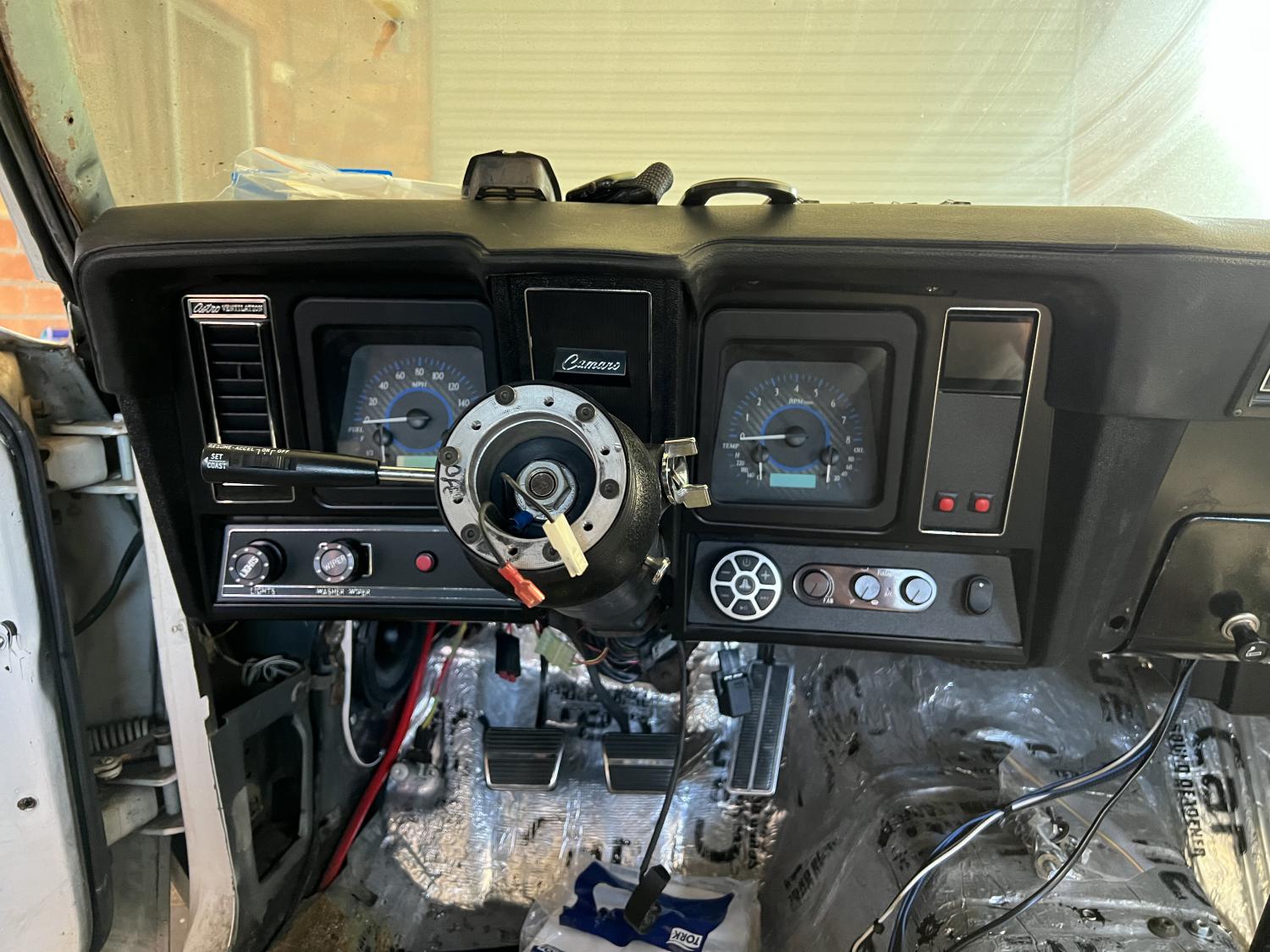

Just to give you an idea on how it sits in my car. Isn’t huge but also not hidden. The other one if it works like mine (just without buttons) would be great. To the right of the column next to the vintage air controller.
