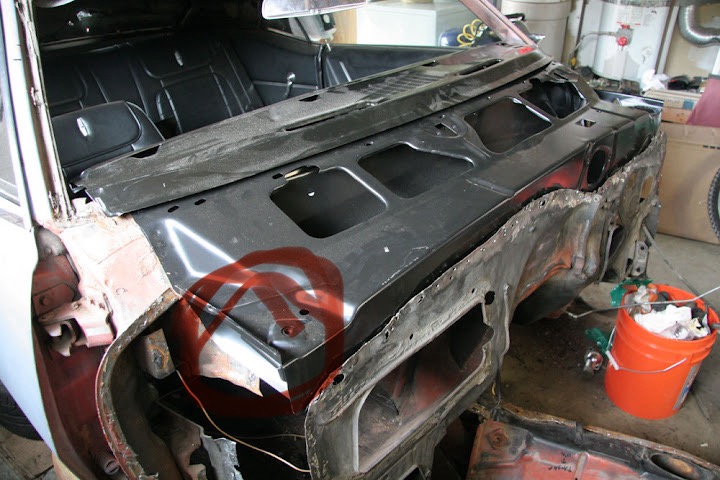

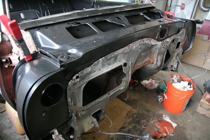

I’m not sure exactly what the area is called. Basically around the cowl panel I’ve got water runs straight down to where the kick panel is. Which then can run into the passenger footwell. Doesn’t see much water but something I need to fix.
Will have to take the guards off to sort both sides eventually but curious how they are normally & what I’m missing.
Hopefully the pics work (they aren’t my car or my pics, just what I could find). I’ve circled the area where the water is coming from & the panel with the red clamp holding it in the other pic. Not sure if water would run under that or not..

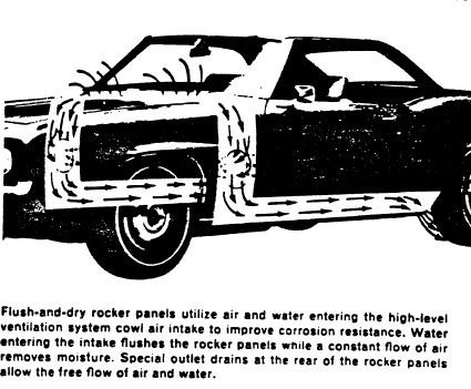

Water is supposed to flow down and into the rockers and exit the rear of the rockers. It was intended to be a flow through flush of the rockers.
If you’ve got water flowing into the floor pans then the drain holes are most likely plugged.

I would pull the kick panel. You will be able to access and clean the drain holes. There is likely a lot of junk in there. Pulling the kick panel is a bit of a wrestling match. You won’t gain any access removing the fender.
There is also a drain hole at the base of the cowl panel if I remember right. It’s been a while since I built a first gen Camaro. You can access it from below without removing the fender. You should be able to use a long screwdriver etc to poke up in there and loosen the blockage while running some water into the cowl vent.

Found this pic.
