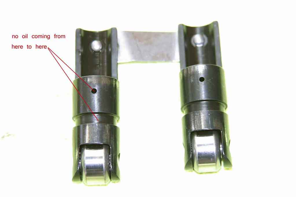

well i pulled the intake and lifters today, looks like to me that I have the wrong lifters, there is a groove going around the lifter but no way for the oil to get from the groove to the oil port that feeds the pushrod tube, also there are no grooves in the lifter bore to help feed this, now these are the original lifters that were in the motor when i purchased it, the bearings and rollers are in good shape but it looks like to me there has always been this problem of no oil to the rockers. Ill look into new lifters ans see if this is dfferent with other brands.
