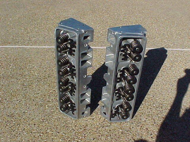

I noticed when I removed the valve cover that the heads had canted valves like a big block. I cannot find a name on the heads but I do have serial numbers on them. I took them to a local speed shop and they were speechless, they said that they have never seen such a drastic offset on the intake valve(said looked like 10 degrees), but told me that they are probably trick-flow twisted wedge race heads, or AFR's. I will post pics tommorow of them. Maybe some one can indentify them.

Yeah, they're probably TFS heads.
I don't think AFR made a non 23* head for sbc.
Post the numbers off the heads.

Could be Dart or Brodix

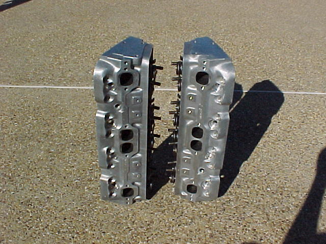

Here are the numbers: Maybe someone can help
head 1: SN 14901
head2: SN 14617-14666
I'm getting them rebuilt .I have no clue why someone painted them??? Sorry about the crappy pics. will take more during the day.

Look like Gm Bow-tie heads

Those are trick flow twisted wedge heads. I'm not positive, but I don't think they make the twisted wedge heads anymore. They were a pretty good street head, but I think the geometry destroyed valvetrain parts.

Those are Trick Flows for sure. I had a brand new set of them and sold them. Not a bad looking head but needs a special piston to work right. Here's what new ones look like.
