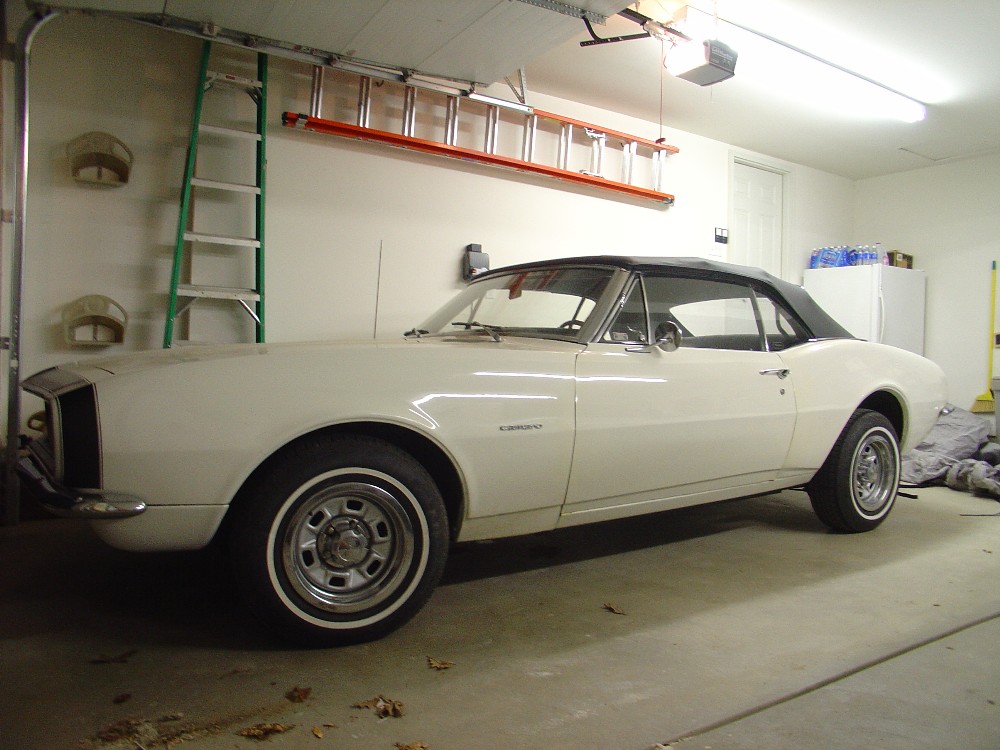

The part i need the most help with is the suspension. I have looked hard at the SWE full frame and the Art Morrison Max-G frame. Both of these option seem to be extremely attractive when it comes to making a vert handle well, especially seeing how i have a body sag issue. But, both require extensive amounts of work , and the car will be a complete teardown.
So Issue 1 would be to frame or not to frame, and in doing so trying to fix the body sag.

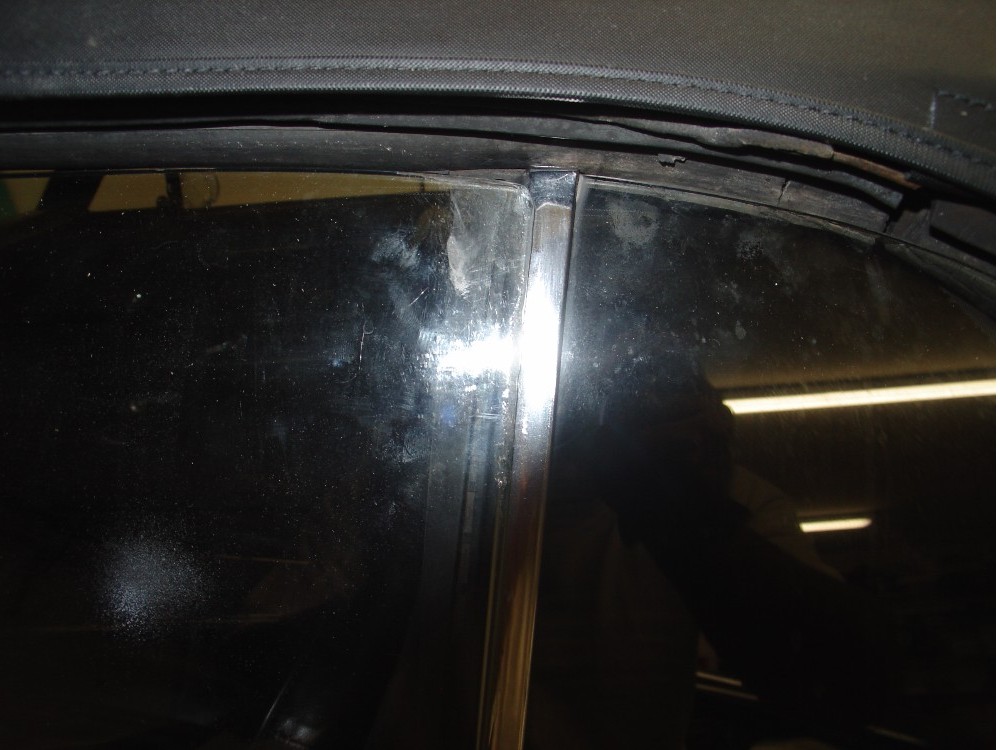

Looking at the pictures you provided the door glass or quarter glass is out of adjustment or there's a problem with the regulator, track, and etc. internally. Looking at the door gap at the rocker panel and where the door meets the quarter panel, it's not any different from most GM cars of this era.
This isn't to say don't do any frame or suspension mods, I say go for it with some discipline and planning and you'll have a nice ride to enjoy.
