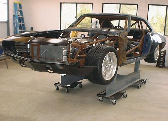

I have hopefully loaded a couple of recent pics. The darn windshield trim blew off on the first fast drive and you can see that looks pretty cobby.

The drive train is about like the engine- Basic.
It has a Muncie 4 speed transmission tied to the Jag rear. The rear gears are tall- 2.88:1 (or something close to that). The rear wheel / tire setup is a 17X10 wheel with a 285/40-17 tire. Actually the tires are so old and hard now that they are more or less rim protectors.
The motor is a basic 383 done at Challenger in Arizona. It was freshened up by Tom Bruhn before going into this car. Looked good and the build sheet says it will do about 500 HP with a tad less torque. Never been on the dyno; it feels OK, but I can not verify the power. The motor meets the trans through a Quartermaster 7.25" button clutch. It is a multi disc rig, like on a motorcycle. It is grabby, but I like it and for shifting, it is great.
From delivery to the present day, the only "tuning" on the motor was to set the floats, check the timing and tighten the gear shifter handle. There was simply no time to mess with any of that stuff.

I'll answer this: Phil is living and working in China and has been since just after the car was originally conceived and started. He's had to supervise the project from across the world.
This year he had a week home during the Christmas holiday. The car was delivered here just before he arrived and we tried to rush to get it road worthy before he got here.
As for 'stock' really there's not much metal that's stock either. Unless you call reproduction panels 'stock'. However it's important to note that the lightening process was so aggressive that most internal steel bracing has been removed, and new floorpans and firewall have been fabricated out of aluminum.
