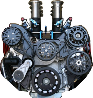

Ilike the looks of fbody..espially after seeing Steves penny
I recall cadilla CTS (??) had nice looking too.Big question is can i use stock gm ac compressor with vintage air systmem?
EDIT: I found this system from DSE . As much as i like all DSE stuff i dont understand the value of this 3500usd system vs stock Fbody.Not even looks.

That is the DSE new setup eh?
Looks pretty good, but looks like the water pump will not allow a factory manifold or throttle body to be used with it because of the T stat location.
Here is your other alternative- The Sidewinder.
