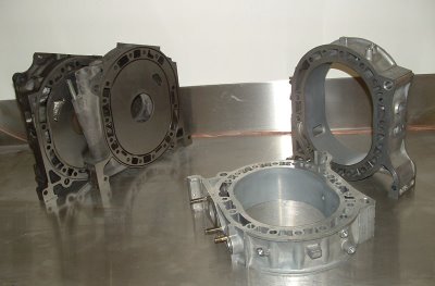

New Parts
Ported secondary Plate
Balanced assembly

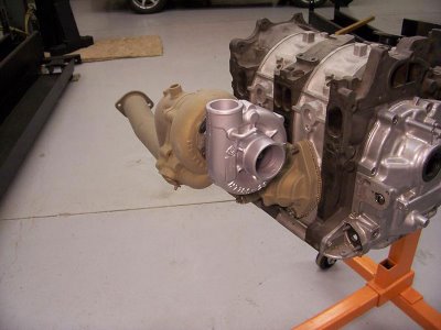

New, Polydyne coated, turbo, exhaust manifold and downpipe

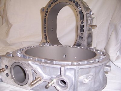

Coated Rotors
New, coated rotor housings

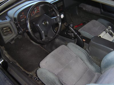

ripped out the old interior this weekend. Time for cleaning, then I'll install the new black interior.
Before
During
After, coming soon
