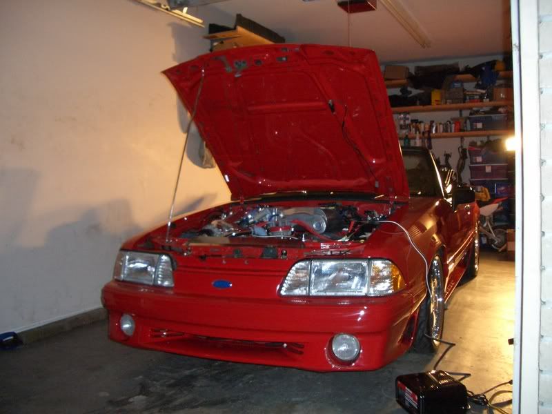

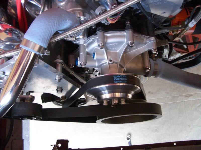

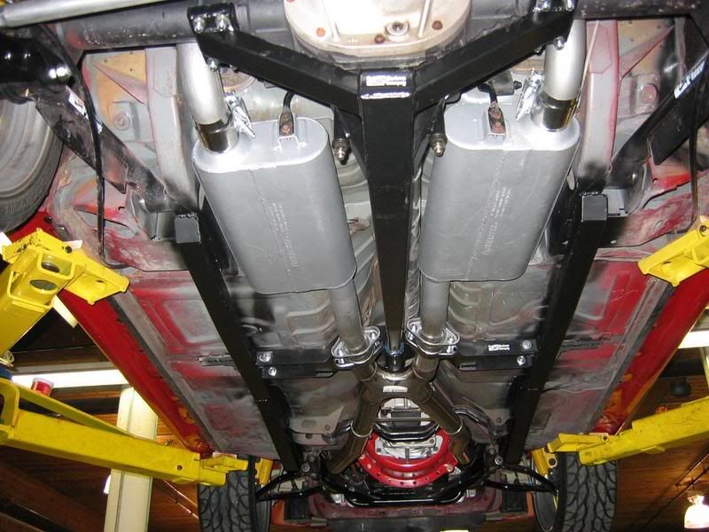

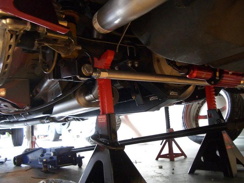

I'm building a Fox Mustang that I guess could be considered "Pro-
Touring". I started with a 4 cyl '86 coupe, so far I've made my own caliper brackets to run Wilwoods on '95 spindles w/ c5 vette rotors, and also on the '03 Cobra IRS (which is coming out soon to get good bushings & other upgrades). I've also installed an 8 point cage and frame connectors to stiffen the car up. Power will come from a 306 with a turbo. The only pics I have are pretty much just mockups, hopefully this summer I'll blow the whole thing apart so I can paint it. Progress is kind of slow because I don't have the budget of alot of other guys, so I've made everything for the car (except for the hotside of the turbo stuff). Here are a few pics:
I had to go into the harness to remove a few unneeded wires, so it's a mess in that pic. It dosen't look so great right now but I hope it will when I'm done!
