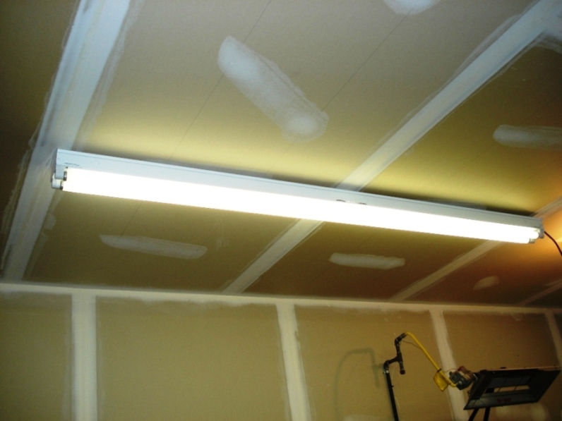

I know it's not recessed but here is what I'm using. It's an eight foot fixture with 2 HO flouresent bulbs. I bought them at Lowes for about $55 for the fixture and about $10 per bulb. I just installed 3 fixtures and it lights my shop area up really well. I think I might need one more.
My shop is about 700 sq feet.
Mike
