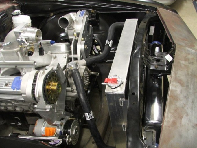

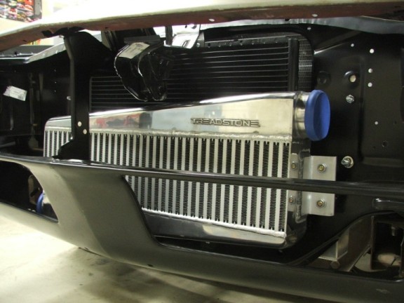

Well after some now or never thinking I decided to add an intercooler. I didn't have the money for a Ron Davis IC so I had to get creative and after many late nights of searching the net I mad a choice to use a Treadstone IC...I feel it's the best bang for the buck and that's what I was after.
This perticular model flows just under 1500cfm which works for me as my ProCharger P1SC max is 1200cfm. It's off the shelf and basically bolts right in! Also I was able to use the stock hood latch and latch brace with a little modification to the brace. All in all I'm very pleased with the outcome and can't wait to plumb it!!
I'm thinking of painting it black so it wont stand out...any ideas on what the best process would be? Powder coat, Paint, ect.?

It looks very nice - made for a clean fit. If it were me and I was going to paint it, I would scuff all the smooth parts with a scotch brite pad, shoot on some epoxy primer, and paint it whatever shade of black. The epoxy should help with the bond to aluminum and provide a good base for the paint.

Could it be anodized black??????
I'd hate to build up too much of any kind of coating material - it will effect it's heat transfer capabilities.

Anthony, that looks great! What a nice clean fit.
Looks like a great deal for less than half the price of some of those other IC's...
I too am curious if a powdercoat would be better/worse vs. paint or anodizing... Wish I had the answer!

I agree with wiedemab, I would look into having it anodized. It would be a thinner layer than paint or powder coating. Should have less effect on your heat transfer.

I was talking with jp and he recommended anodizing it for the reasons you guys mentioned. It is all aluminum and it can be done so I think I will look into this option more....hope it can be done for a fair price!!
