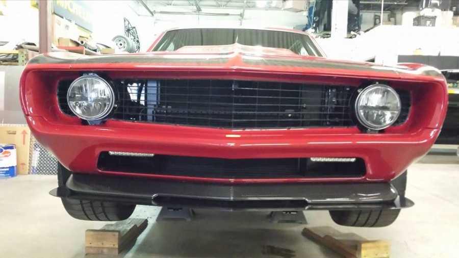

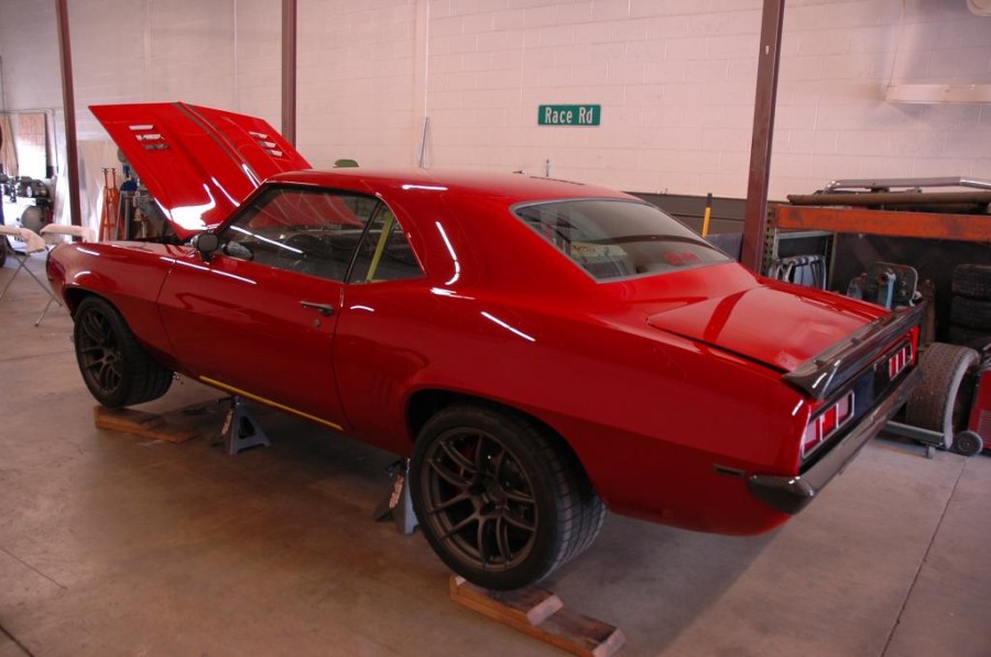

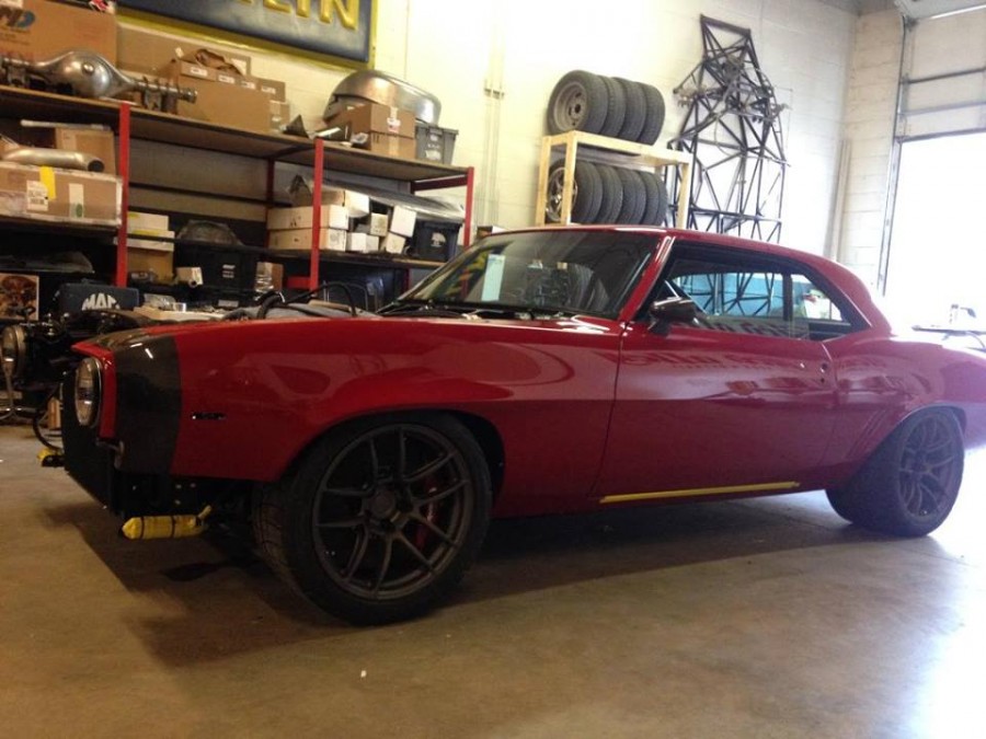

Sled Alley did a great job on the interior. We used all C.A.R.S. parts and the doors sound like a vault when you close them. Just a great thud sound. We used some Dyna Mat and a lot of the lighter Tac Mat. Matt and Paul also put the front clip on the car. Sled Alley and the Dutchboys make a wicked team if you want a straight body.

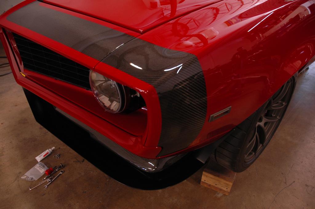

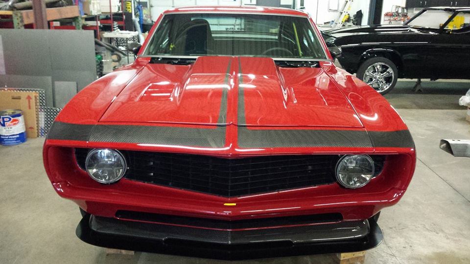

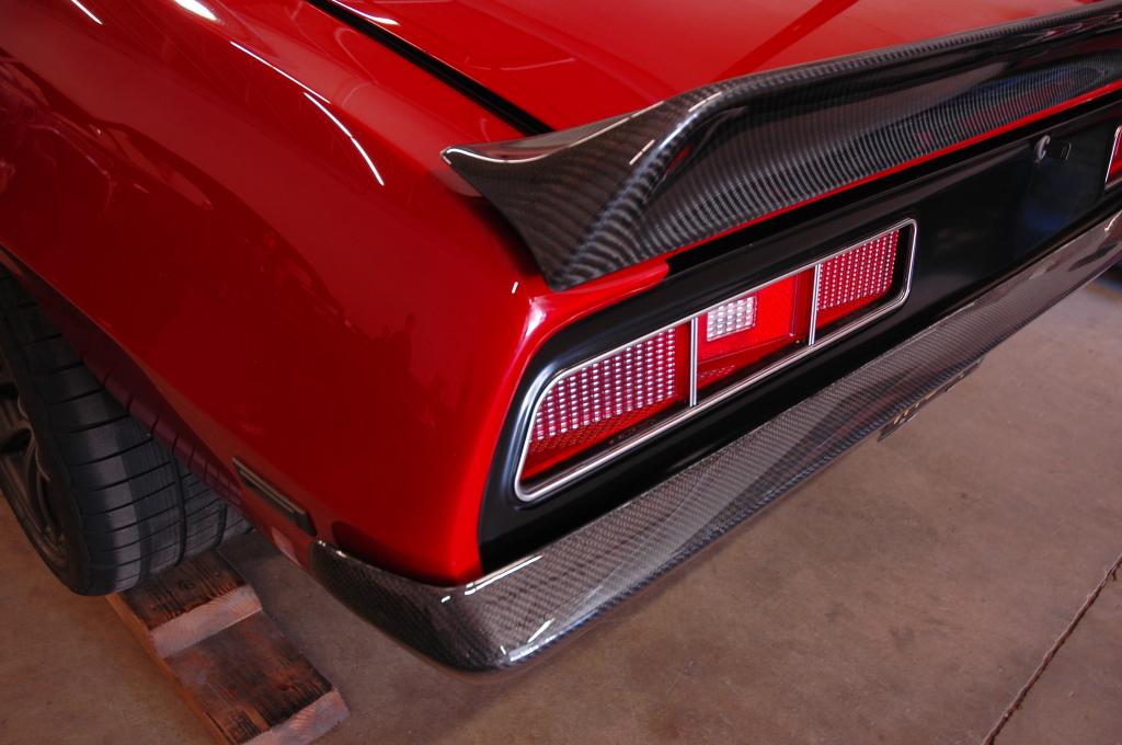

We finally got to see the car outside on the ground and the paint is stupid nice. The fit, gaps and surfacing is the best yet. The car is very stunning. (Sorry I wanted to get home and forgot to take a picture.) Matt drove the car up and back and it has a unique look on the road. The PPG red is very deep. That against the carbon fiber has a nice look in my opinion.
