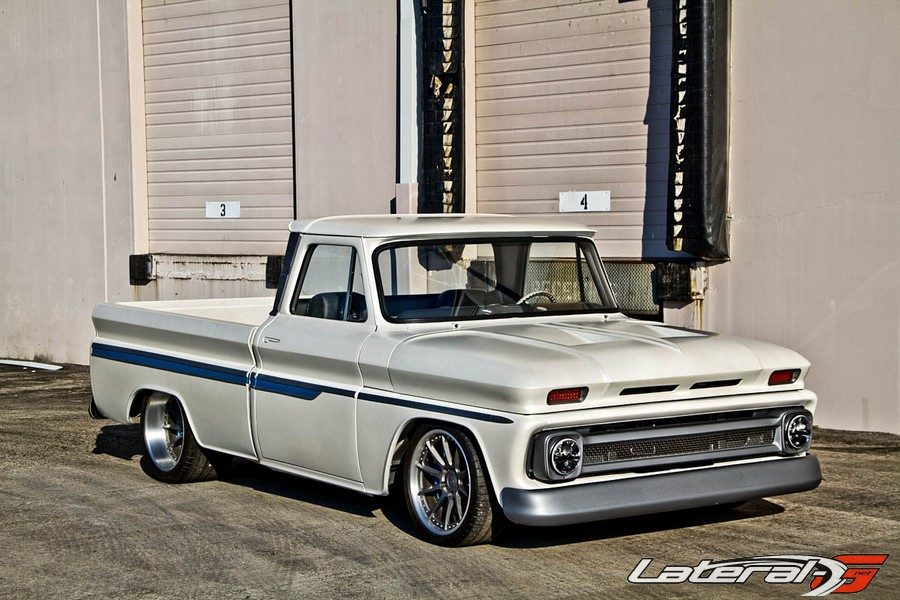

Tires are just about the biggest limiting factor in any form of racing. The size, style, and treadwear rating all limit how much tire is on the ground and how much it’s sticking to the ground. We try to put larger wheels on there to allow for a larger tire and more surface area touching the road to increase traction.
We expect a lot from a set of wheels. They are expected to last for thousands of extremely hard miles on the track, numerous sets of tires, stay true after a flat, and most importantly – look good while doing it. We caught up with Forgeline President David Schardt who helped explained everything that goes into a set of wheels and tires.

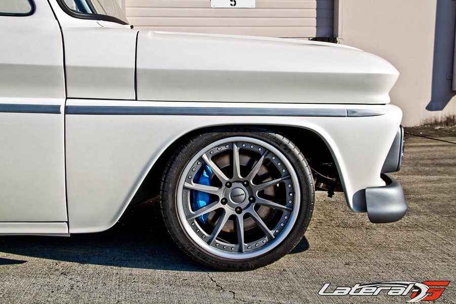

“There are a lot of factors that usually go unseen from the casual racer. These factors effect how we produce a wheel and ensure that the wheel performs flawlessly,” explained Schardt. These factors include what the intended usage is, weight of the vehicle, how much downforce the vehicle is seeing while at speed, the type of tire that’s mounted on the wheel, and what the wheel itself is made out of. “When selecting rims and tires, most people just look at the weight rating from a static standpoint of sitting in their garage,” explained Schardt. But there’s much more to a set of wheels than meets the eye.

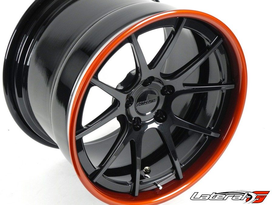

forgeline-wheels-pro-touring-03

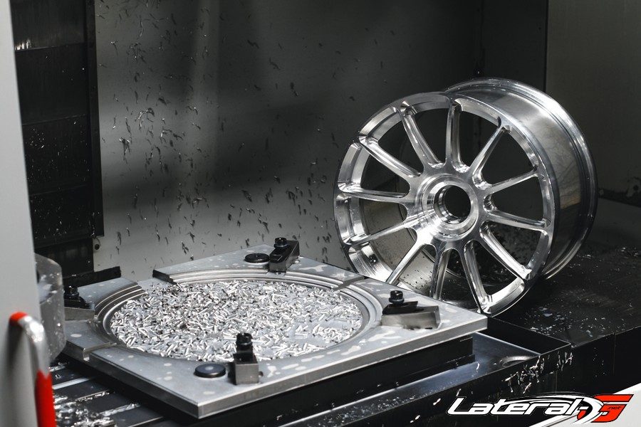

Forging Wheels With Forgeline

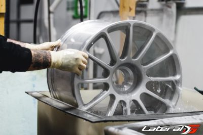

To dive a bit deeper into the making of a wheel, Forgeline has to know what kind of materials to choose for the wheel. This material has to have an acceptable level of strength to withstand forces it will or might see. The material also has to have a specific gravity, meaning a light material like carbon fiber or a heavy material such as steel. On top of that, they look at elongation, which is how much the material would stretch before see failure. Forgeline also looks at fatigue resistance where the wheel must hold up under extreme stress time and time again. Finally, they look at more obvious factors such as cost and how hard it is to manufacture. When looking at all these different factors, different materials perform better and worse in each category. The overall winner is 6061 forged aluminum, which is strong, flexible, light and cost effective.
