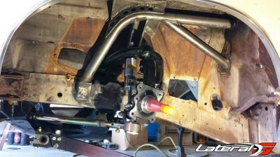

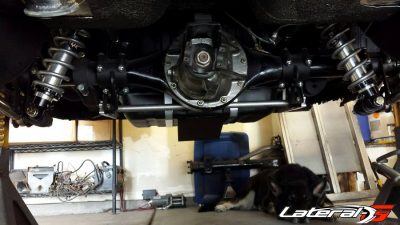

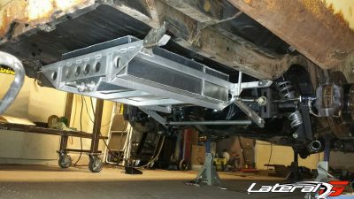

“The Charger has Pro Touring style suspension with coil overs at each corner. The rear suspension is a custom five-link set up. The entire car is fully caged to eliminate flex. I’m also utilizing Wilwood brakes at all four corners while using one of their under-dash set ups,” explained Birdsong. He also plans on doing a little drifting in the car, so a hydraulic handbrake has been added as well.

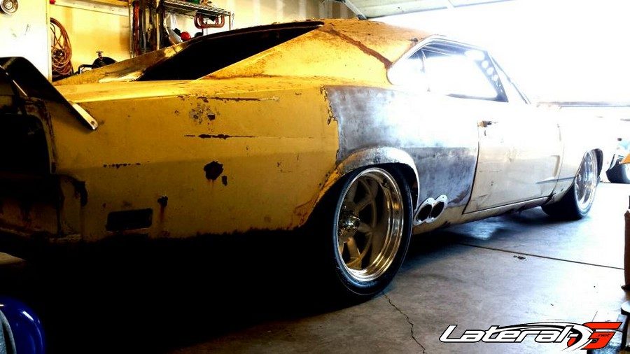

There’s a ton of custom work done to this Charger as well from the front and rear spoilers, all the way to the hand made side-exit exhaust. We can’t wait to see more of this build and more importantly, see it out tearing up the track!
