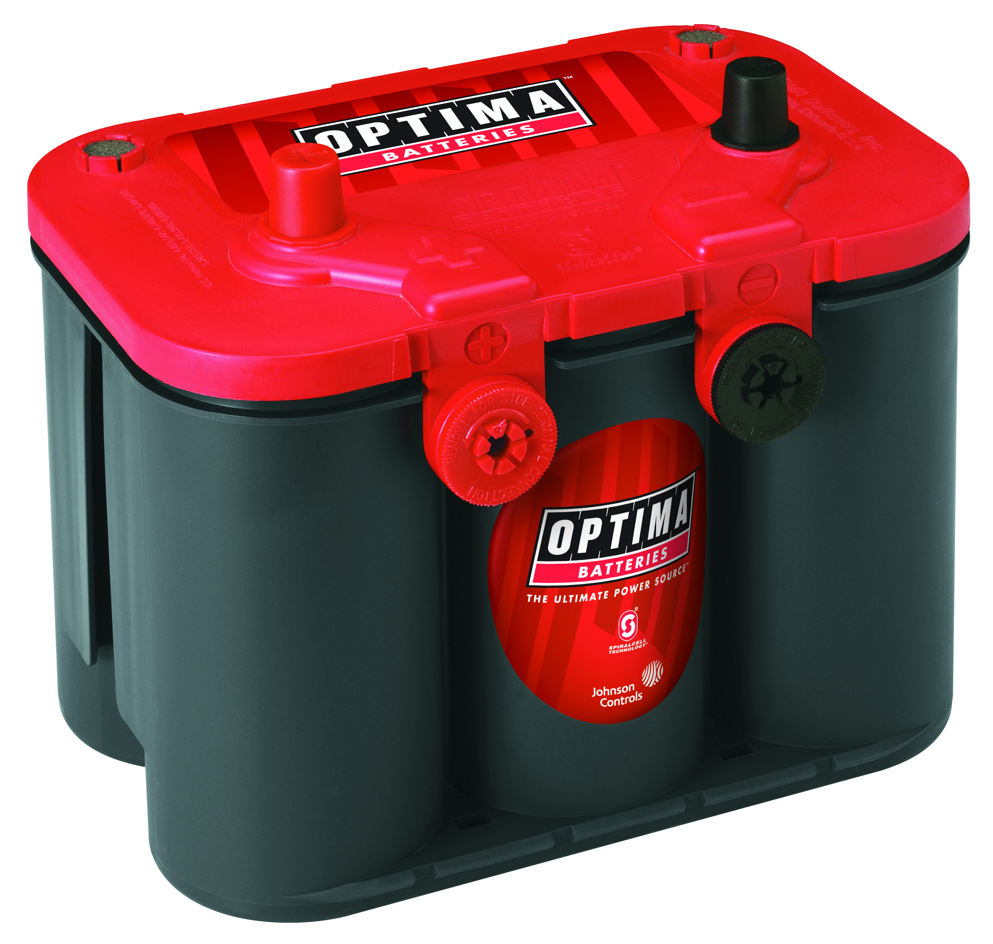

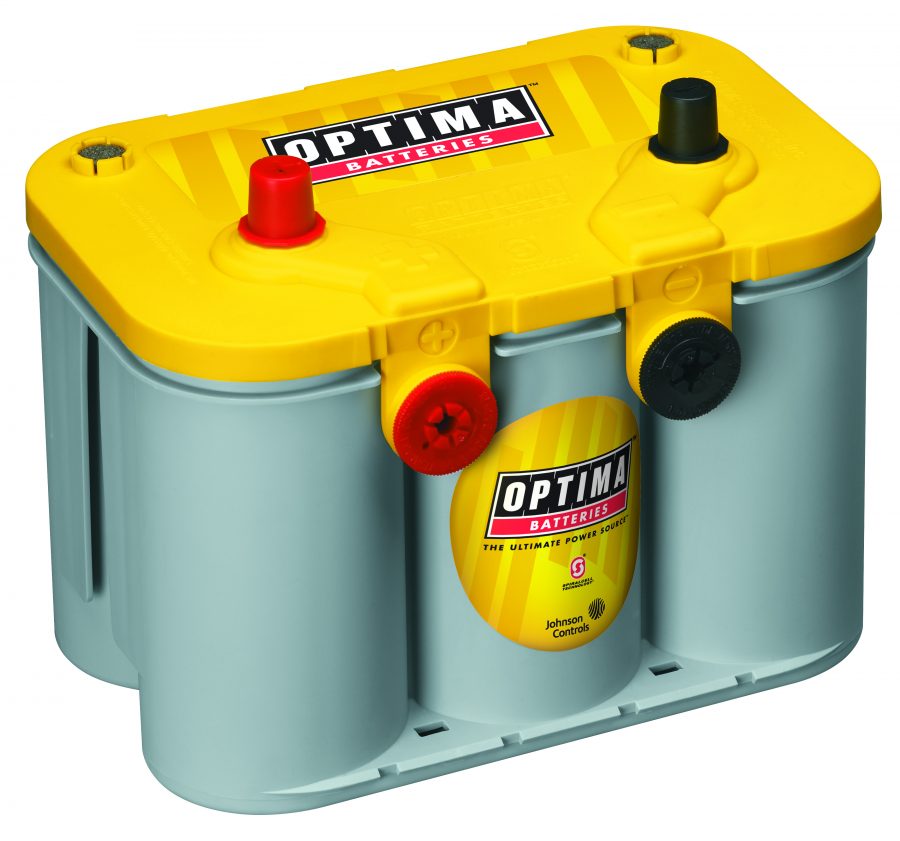

First, before storing your vehicle, check the voltage to ensure the battery is fully charged (~12.6-12.8V for REDTOPs and ~13.0-13.2V for YELLOWTOPs). It’s important not to rely on your alternator to fully recharge the battery; instead, use a battery charger to top it off before storage. If it’s not fully charged beforehand, give it a boost with an OPTIMA Digital 400 or 1200 Performance Charger. OPTIMA chargers can charge batteries some other chargers cannot and are specifically designed not to overcharge your battery.
