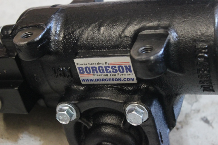

After hearing Jeff ramble on about all the possible issues with the Grand Cherokee box, we knew that wasn’t an option for us. We wanted a brand new, never been rebuilt box from Borgeson. “Our boxes are 100% brand new with no rebuilt, worn out parts in them. They are made to our precise specifications and feature a full 88 degrees of rotation so you won’t see any impact on turning radius. We use a modern valve that drastically improves steering feel as well,” explained Jeff. We were sold on it and told him to ship us a box – less than a week later it was sitting on our doorstep.

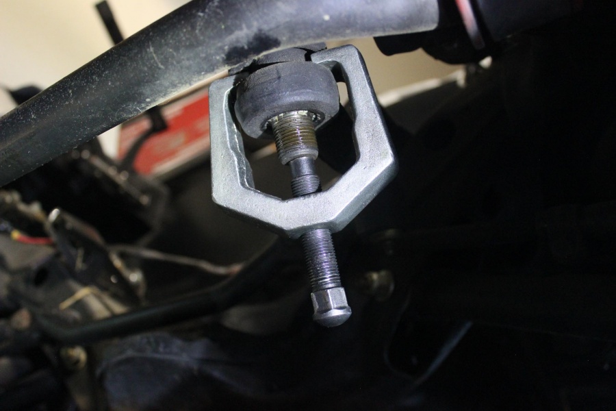

Installation of the box is pretty straight forward. We started by removing the old box first. We didn’t have a pitman arm puller so we did rent one at the local auto parts store for $20. Our first step in the process though was to disconnect the power steering lines and drain the fluid into a pan.

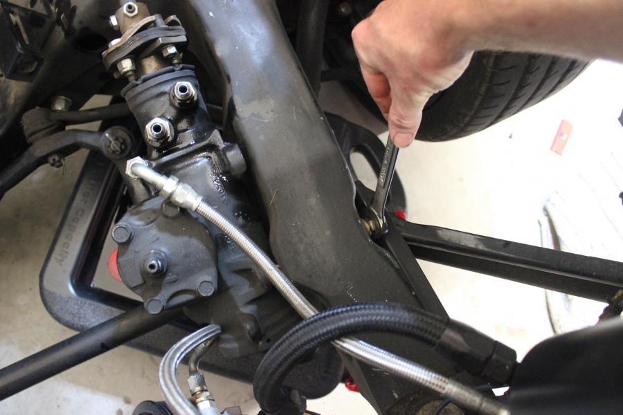

Then we crawled under the car and removed the big nut and popped off the pitman arm from the box. After removing the rag joint, we simply removed the three bolts holding the box to the frame and slide the whole box on out.

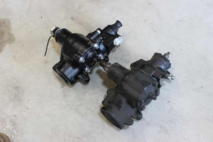

Comparing the two boxes side-by-side we see they are very similar in size and weight but the new Borgeson box was smaller in a few areas which might help those that have header or accessory clearance issues.

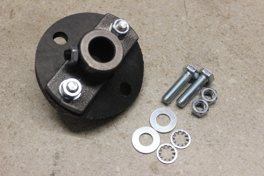

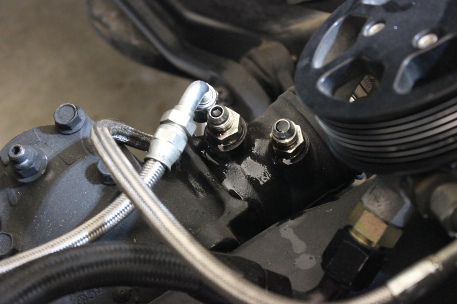

Installation was just as easy as the removal and we started by installing the new coupler for the rag joint that’s needed for this new box. Then we slid the new box into it’s home and bolted it up using the three bolts. From there we installed the pitman arm, tightened down the rag joint and attached the power steering lines. One quick note on the lines is they are set up to use an O-Ring style fitting but if you are using a flared fitting like us, Borgeson supplies brass inserts to adapt them.
