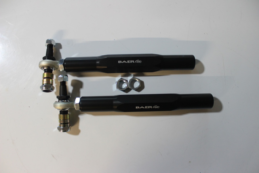

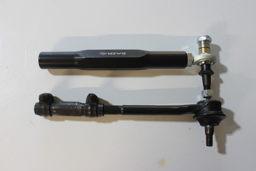

Baer Brakes bump steer arms replace the outer tie rods with a rod end joint. This rod end will provide much more precise steering to start with. The beauty of the system is that you can adjust this new arm down back towards it’s original position or even closer to the ground to almost completely eliminate bump steer. More precise steering and elimination of bump steer – a win-win in our book! On top of that, these new Baer Trackers are ultra-beefy, much stronger than the factory tie rod adjusters and they just look way cool under the car.

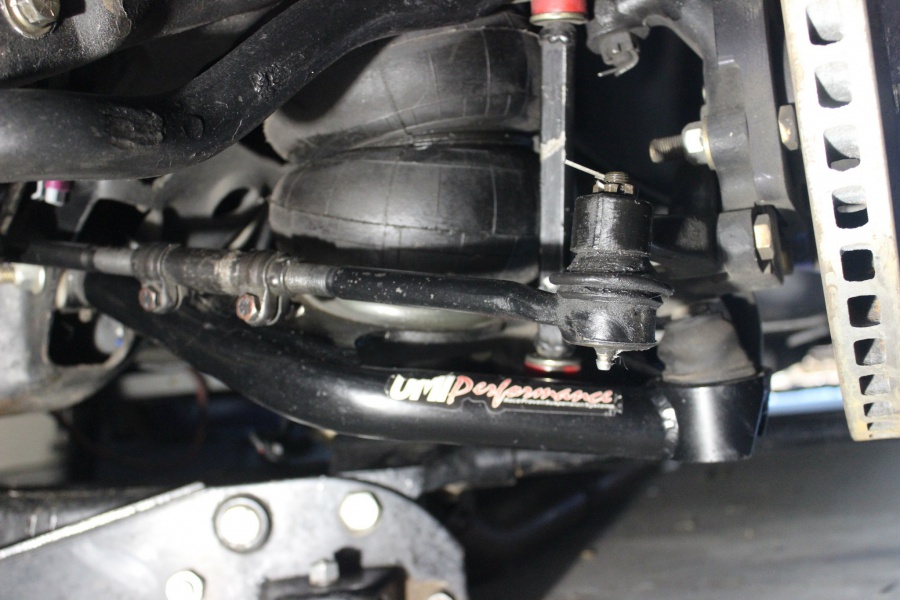

We started by jacking up the front of the car and removing the wheels to have more access. Then we removed the cotter pin on the outer tie rod castle nut then removed the castle nut. Using a hammer we popped the tie rod out of the spindle. From here we removed the outer tie rod and tie rod sleeve.

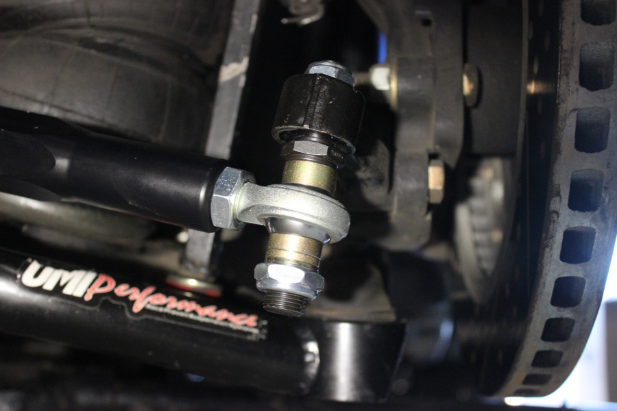

To install the Baer Trackers, we threaded the new jamb nut onto the inner tie rod. Then we installed the new outer bolt that goes into the spindle and attaches to the rod end. From here we threaded the new Tracker assembly onto the inner tie rods until the rod end lined up with the bolt going through the spindle. One thing to note is that we made sure not to move the spindle during this process so that our alignment will stay as close as possible. We will still need to get a proper alignment, but this will help it remain close.
Since this car has updated suspension and has been lowered, we knew the spindle we rotated quite a bit back. Using the supplied spacers we bumped the Tracker arm down a bit as a bit of a ball-park to where it should be. One way to help get it close to line it up with your lower control arm so they are parallel.
