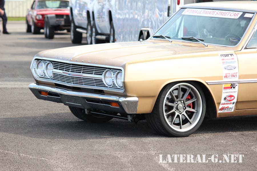

The last part to make this a rolling chassis was a set of wheels and tires. Aaron called up Forgeline and ordered a set of RB3C’s. The fronts are 18×9.5” with a set of 265/35 BF Goodrich Rival’s wrapped around them. The rear are 18×10.5” with a 295/35 tire, respectively.

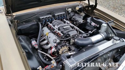

Before setting the body back on the chassis, Oberle went ahead and installed the driveline as well. The motor is a stock LS1 with some additional goodies thrown in. To start, a Comp Cams XFI RPM X269 bumpstick was installed to allow the motor to breath. A set of 241 heads were utilized, and a Lingenfelter intake manifold with Holley fuel injectors finished off the top end. A set of Hedman mid-length headers finished off the motor, with the ignition system handled by a Holley HP EFI set up.
Backing the LS engine is a six-speed T-56 transmission, which allows Oberle to boil the hides in 1st gear, and still sip fuel in 6th cruising down the highway. The transmission was completed with a slightly modified B&M Ripper shifter. The power then twists its way to a Ford 9” rearend that’s filled with 31 spline axles, Eaton tru-trac and 3.70 rear gears. This combination put down 383 horsepower and torque at the rear wheels, no slouch at all. But there’s always room for improvement, right?

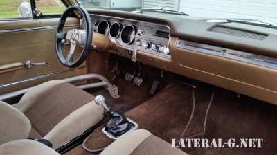

The cockpit of this bruiser has remained pretty much stock from when Grandma drove it. Oberle added a harness bar, so he could run a set of four-point harnesses. These hold him in his custom made Recaro Expert-S seats that were upholstered in brown to match the rest of the car and interior.
Keeping tabs on the vitals of the car is a set of Dakota Digital VHX gauges. These gauges also allowed him to document the fastest he has taken the car, which happens to be 130 MPH around the banks of Daytona International Raceway. Naturally, the interior has lots of one-off billet parts too. Our favorite one is the lightweight, NASCAR style shift ball.
There’s no frills with this interior; It’s basic and to the point. There’s no power windows or locks. There isn’t even air conditioning or heating. If you’re cold, wear a jacket. If you’re hot, roll down the window.

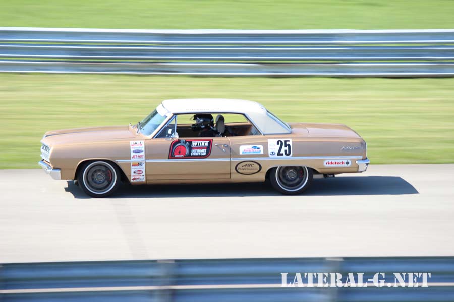

With his Chevelle finally finished, Oberle hit the tracks. Over the last year he’s gone to over a dozen different events, from Pittsburgh International Raceway, all the way to Daytona and everything in between. He wanted to say thanks to Tom Farrington and Billy Utley for their patience and guidance as he built this brown bruiser.
