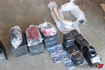

Installation was easy, taking less than an hour and requiring no fabrication. First we laid out the parts to see what we had. Everything was included in the kit – a 4″ polished tube, air filter, couplers, hose clamps, and even a powder coated heat shield.

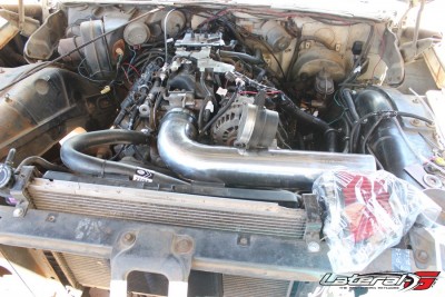

But what if you have a car they don’t make an intake for? Spectre has that covered too. “We have many different styles and shapes of tubes, couplers, filters and everything else needed to custom make a cold air intake for just about any application,” Morrow told us. We had a really off-the-wall LS swap we were just completing, that needed an an intake as well.
We showed pictures and dimensions to Mike and his team, who then complied a bunch of different components for us. Our original intention for the cold-air intake was to have the tube come off the throttle body, complete a 90-degree turn, shoot past the alternator, and complete a second 90-degree turn with the filter ending up over the exhaust manifolds on the drivers side. However, this defeats the point of a cold-air intake when all the heat from the exhaust is rising straight up and into the filter.
The solution was easy – we eliminated the last 90-degree turn, putting the air filter just past the alternator. Now, this isn’t the optimal spot either, but without modifying the core support a bit, this was the best solution. This installation was easy and straight forward as well, we just mounted the 4″ polished tube, and measured three of four times before cutting. After trimming the tube a little bit more, the filter cleared the alternator, and hung nicely off to the side.
