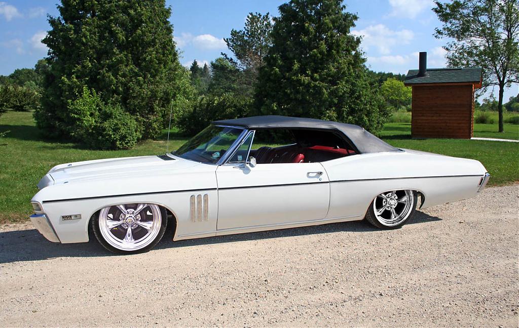

Sorry, I actually loaded a pic up but it seems that it dit not work.
Right, 17 or 18 will not bring the look I am after, it would almost look stock.

The white 61 Impala in the members ride section got the look I would loooove.

Before some months I made a Photoshop-fake of my car in the look I would like it, hope this time it works with uploading the pic.
