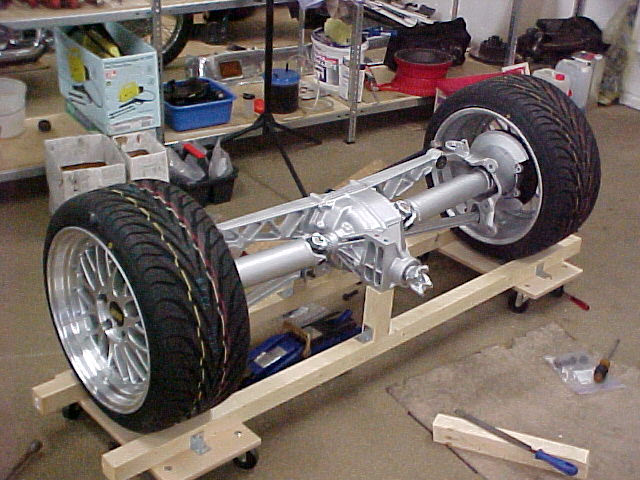

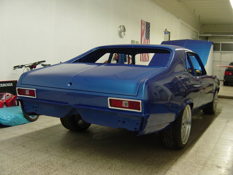

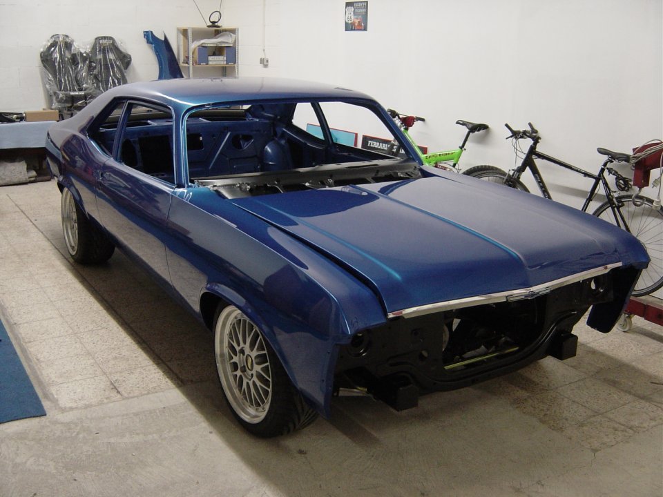

dear people,
i would like to join the forum and introduce my project. i am a 34 year old automotive engineer rebuiling my nova to what i call a car
i guess there is a personal page here somewhere to place all the details ....
some details are 406 engine, 215 dart heads, roller solid cam with roller rockers, eagle crank, eagle h-beams, fine-balanced, edelbrock air gap, holley double pumper.
BMW M3 brake rotors, porsche turbo calipers , Corvette suspension all around, mustang cobra steering rack.
all around poly windows tinted with one piece door windows, all windows custom made, Sparco Race seats .......
the wheels are superlight BBS Le Mans, the interior comes all new, all parts are either new or sandblasted and powdercoated ....
these pics are a little bit old, gas tank and bumper rear are installed, door handles too, grill and so on ...
