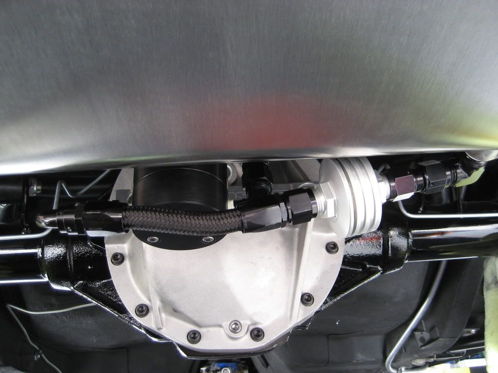

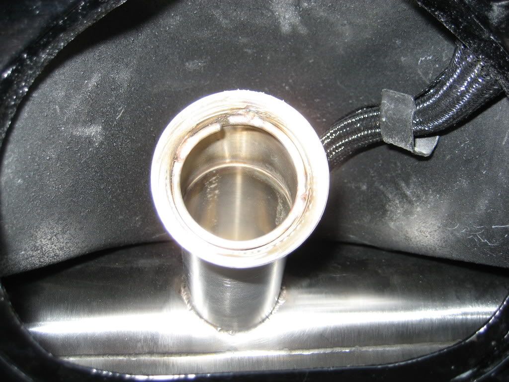

Default Updates
The complete fuel system is done except for the gas cap. The stocker won't fit. I used 1/2 aluminun moroso line from the G Bar bracket to the fuel regulator on the front frame. The rest is AN and black pro flo 350. I also made a bracket for the fuel pump with rubber insulators up against the tank. It is wired from the trunk and the wires run on top of the tank.

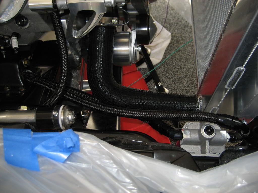

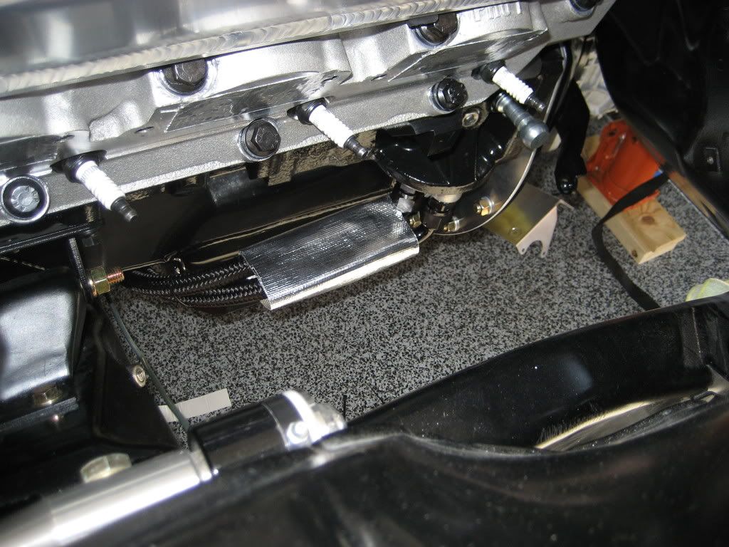

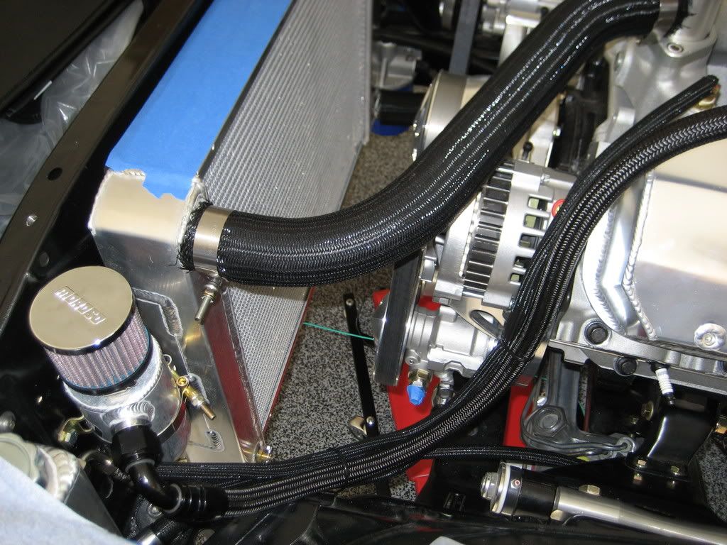

Default Oil lines
I have my remote oil filter and hose done. I used heat wrap where they are close to the headers and snaked them between the frame and oil pan through the engine mount. She ready to prime. Pretty slick and looks damn good too.

Default Power steering/breather system
Power steering is almost done. I need to call DSE in the morning. I can't get a fitting on the pressure side of the rack. Probably going to need a 45 right out of the rack to get a fitting to screw on. Anyway, breather system is complete. Power steering resorvoir and all the other lines are done.
