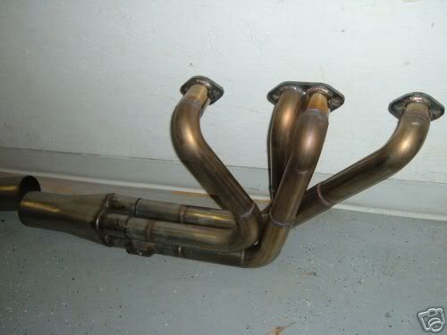

Mr Chicane, what is your analysis of these? (1-3/4" stepped to 1-7/8" with 3.5" collector) (sorry for the quick threadjack, but it's sorta related!)
