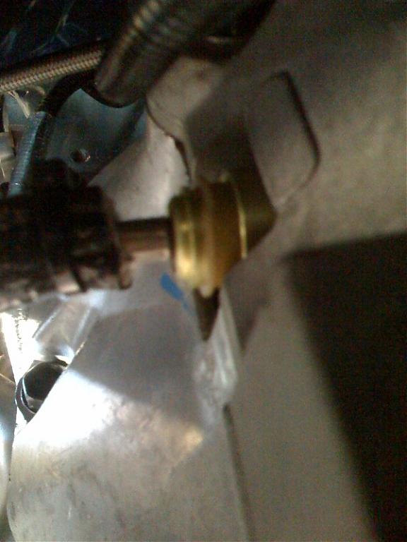

How far into the connect receiver on the GM slave does the master connect fitting go? I have the ATS supplied master and slave.
I hooked it up but the male end only went half way. I can push the connector all the way in but it rebounds to half way. Is half way correct?
I have inculded a photo. The hyd line is wrapped with a fire sleeve.

It's been a while since I messed with it, but I'm pretty certain that's how mine is, too.

You can see the white sleeve. To remove it, you push that sleeve in with a special tool or a screwdriver, if you are real careful. If it went all the way in you would not be able to get it to release.
