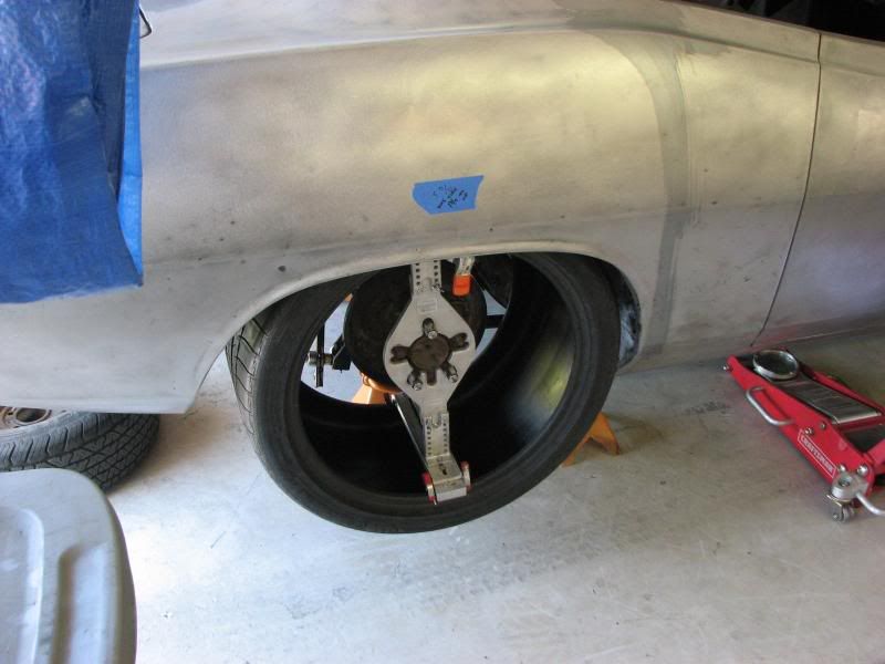

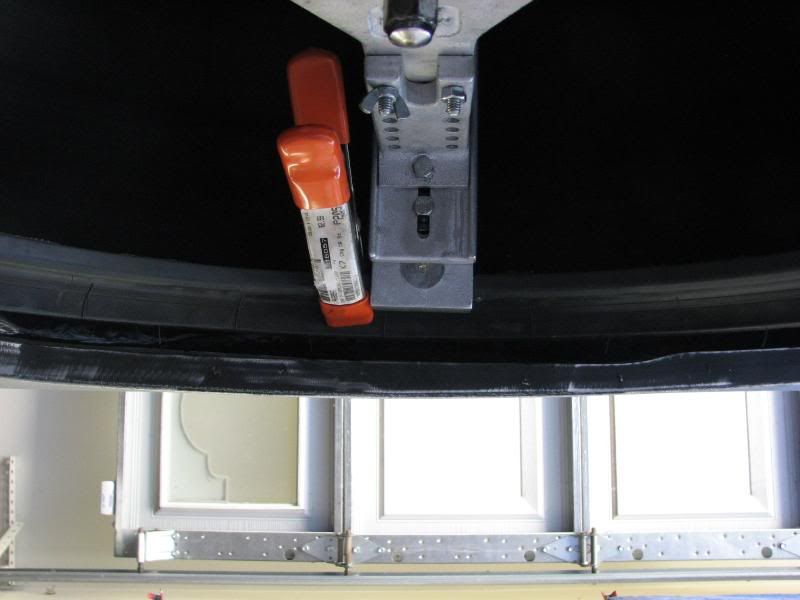

At first we had some clearence issue with the steering arm attachment, so I we had to swap out to a more shallow hat and move the rotor out a tad... its close but they fit now
Since thats been all mounted up, I've been trying to measure for wheels....that has been a huge PITA.
I wanted to thank Marty (Syborg) for lending me his Mount Mate to help the job. I borrowed it back in late July (anticipating my brakes would arrive soon) and then we had all the brake delays and its been sitting in my garage unused.... thank you Marty for being so understanding on the delays. I'll have it back to you next week, I promise.....
I've also been bugging Jason Rushforth with questions and trying to work out a way to get a decent lip on the front wheel. Unfortuately with these big brakes, its widened my track width some and then the caliper overhang is gonna push the spokes out some, so it dosent look like I will be able to get the dish I was hoping for, but thats life I guess.
Then I got back and forth on the 19x8 or 19x9.....245-35-19..... I tried a ton of BS setting for both, at the current ride height (based on the Air Ride ride height suggested for this shock etc), its pretty close the fender lip near full lock.
So I decided on either a 19x8 with 6 BS or a 19x9 with 6.5 BS and everything clears on the pass side (the one I've been working on the entire time). Figured I should make sure on the driver side.....and neither one works on that side !!!!! I dropped a plum bob from the fender lip and measured to the hub on both side and it looks like my fender is about 1/2 inch pushed in on the driver side. Everywhere elese I measure, it appears that the frame to hub etc is the same so I dont think the frame is moved over. There was some previous damage to the driver side fender, so I think it bowed it in slightly near the fender lip....great...more work......
If I do more BS, then the Mount Mate hits the tie-rod at lock...plus I guess 6 BS is the most I can really do on an 8 inch rim anyway....so best I can figure is do the 19x9 with 6.5 BS, have a slighlty larger lip, and fix the driver side fender opening.....

Also sound like your fender may be pushed in. Take a tape and measure from the fenderlip plumb bob to the frame rail and see what you get on both sides.
If that is the case i have the fender lip roller that you can use and instead of rolling the fender lip you can gently flare the fender back out. I did this on the bed of my truck and it worked great.

I've measured from just about every fixed point I can find to the fender lip and they are all about 1/2 off from side to side. If I sight down the fender, I'm pretty sure I can see it bow in just alittle. Plus on the Cuda there is a little flare just over the opening and if I put a straight edge from lip to body line it's pretty perpindicular on the "in" side and angles inward (body line above is inboard). The definition to this small "flare" is not nearly as crisp as on the "good side" either. Both are original fenders, but both have had some damage over the years
So I'm pretty sure its pushed in about 1/2 inch near the opening on the driver side.

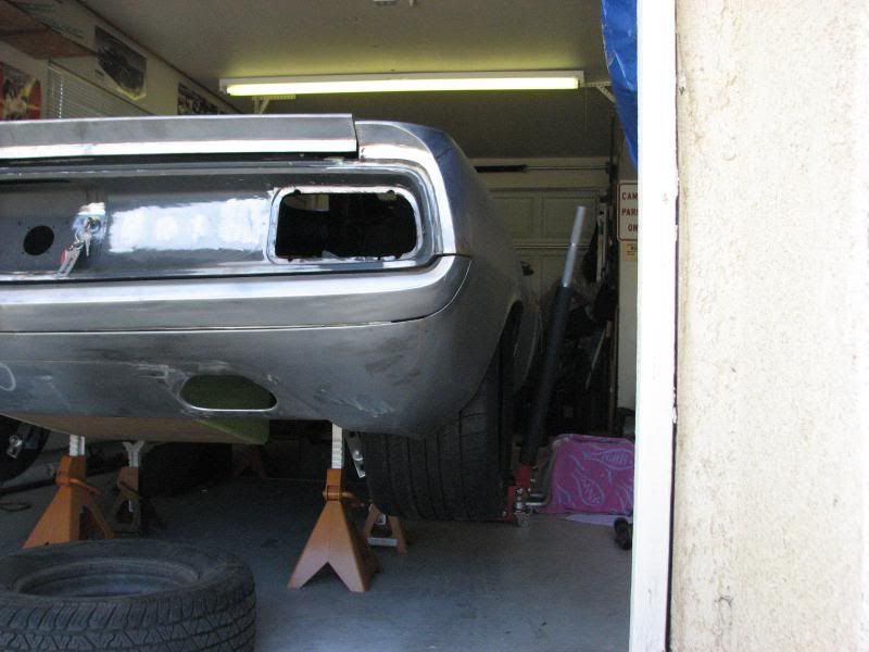

Today I started to mess with the rear tires.... I'm using my stock rearend just to get me in the ballpark for BS and see what I have to work with. The plan is to get the rims and tires and then measure and order a custom Dana 60. Right now I just want to see where I stand......
This is the passenger side lip clearence right now... the tire is alittle crooked in the pix..... I havent done any trimming or rolling of the fender lip yet, but that is the plan for sure. I should be able to move the rim out just a tad more and still have fender clearence and enough space up top to sink the tire up into the wheelwell when its aired out..... I have about 3/4 inch of clearence on the inside right now...so probably move it out about 1/4 inch and I should be perfect.
