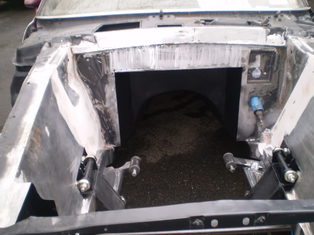

3-7-10 finally finished up the welding underneath from the rear crossmember back so i took advantage of the day and sprayed the undercoating ..one container to see what the results were ..Its a product called Raptor Liner...it has the texture im looking for..so ill finish the rear tomorrow..check out the pics.....

Ok so i liked the way the Raptor liner came out.... but it was a bit to shiny ,so i whent over it with a satin black for a more original look ..i also reversed the colours on the front end parts ..check out the end result...

4-12-10 i have been finishing up the sheetmetal and modifications along the way ..recessed the firewall...recessed the wilwood polished master cylinder..mounted the front modern mustang seats and tested ..power fwd/back and height adjustable as well as lumbar support now you dont find that in to many 69 stangs.....steering is in and finished up..she is off to the body shop by this week end...pics to follow.
