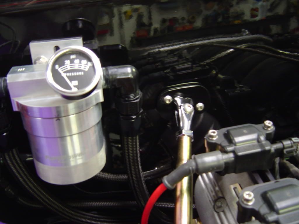

-10s that's whats on the block:
Routed the lines behind the inner fender. Amsoil's remote bypass kit.
