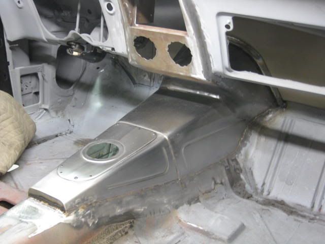

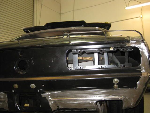

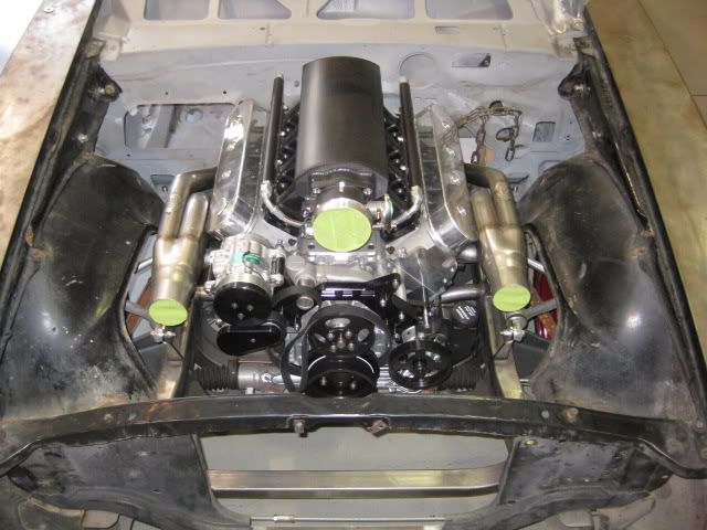

Now that our 69 project is off to paint, were able to focus more time to our 67.
frame work for rear spoiler and bodyline added to rear valamce
trans tunnel and center dash mods fabbed, building firewall now.
initial mock up of TT ls3, theres going to be a whole lot of plumbing under the Carbon fiber hood!

Looking good.Trans tunnel is cool.

Steve that all looks great. That intake looks very nice in there (looks to be a precision metalcraft, right?) Did you have it anodized black, or ?
CF hood, are you sure it won't melt? I was thinking of getting one for my project but not sure about the high temps w/turbos...also in my case w/Iron Eagle SBC the weight savings = throwing a deck chair off the queen mary

TT LS3 = much power and torque. How much power are you guys looking for from that engine set-up?
Rob, it is a black anodized precision metal craft, everything will be black. Turbos are black ceramic, and all plumbing, valve covers ect. We will be lining the underside of hood in a product called lava shield, hopefully that along with turbo placement, we will be alright.

Originally Posted by tones2SS View Post
Nice update guys!
700 w/10 lbs boost. We will be dyno tuning when closer to completion.
