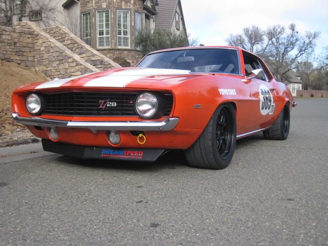

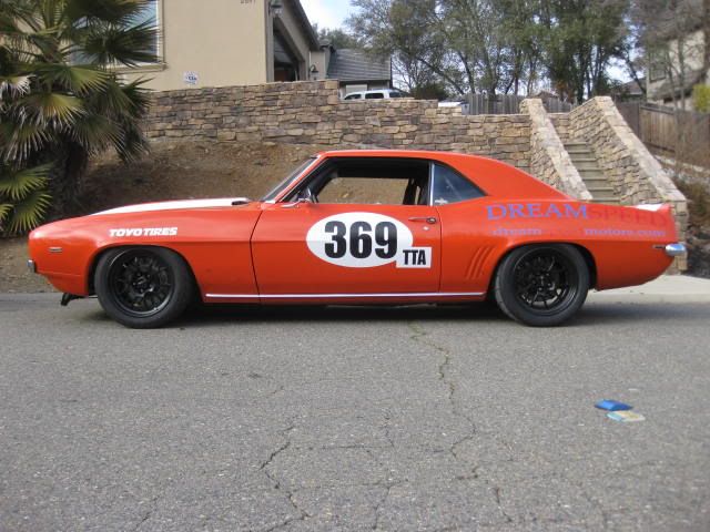

I really like the all satin black look. My car is still on stock wheels but I've painted them satin black. Whats your plan for tying that in to the paint scheme? Are those wheels the GA3's/GA3R's? What size wheel and tire combo?
Dave
Thanks Dave!! Valance, grill, front bumper, header panel, hood, cowl panel will be satin black. Black stripes on the deck lid with satin black rear spoiler. Seen this look on a vintage '69 SCCA car and loved it.
Wheels are GA3R's. 17 x 9.5 front with 275/40's shaved RA-1's, rears are 17 x 10.5 with 315/35 NT-01's.

Originally Posted by Rybar View Post
Looks good Gaetano!
Thanks Rybar!! I thought I was going to hear a comment about polished lips from you. Really glad you like them!!
That was my preference, go for what you like and what suits your needs. When you have an all black wheel I feel the tire and wheel lose the definition, thats why on an all black I like it when a pinstripe is used. White red, maybe orange in your case would look cool. Would be cheap and easy to try out?
This is the plan.
Gaetano Cosentino

Originally Posted by compos mentis View Post
Great to see some nice, fat, juicy 17" tires ...and home for the holidays.
Lookin' good.
Thanks Skip!! Them NT-01's were made the 36th week of 2011 and are nice and sticky. I was picking up every peice of gravel on the street.
