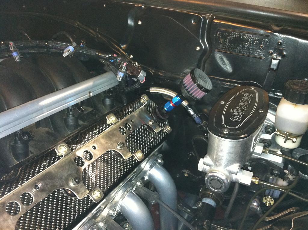

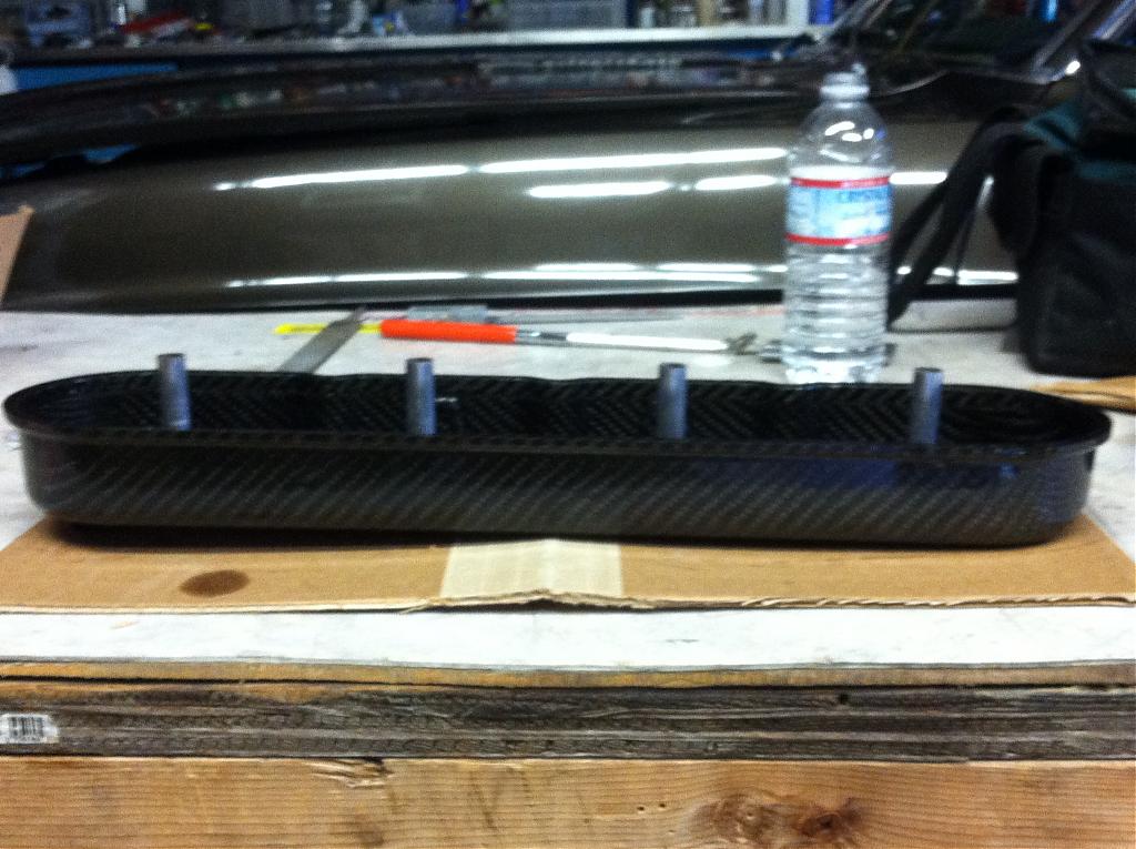

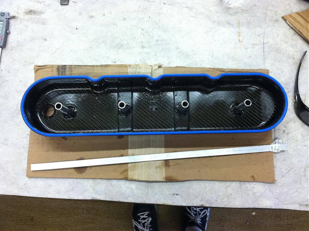

Some times its hard to win and feeling that way now. I have those carbon fiber valve covers and now my drivers side leaks oil. I don't think it leaked before because there was vacume when it wasn't vented. Now that its vented the darn thing leaks. Replaced the gasket and it still leaks .
Scott has those and has a ton of miles on them without problems. Bummer. I wonder if it needs just a bit more crush on the gasket (slightly shorten the stands in the cover).
I thought about that and wondered what would be the best way to shorten them.
Here some pics of round two and my breather
