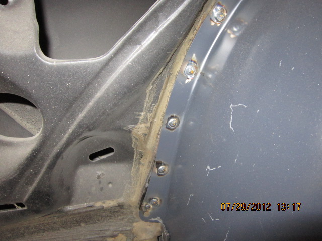

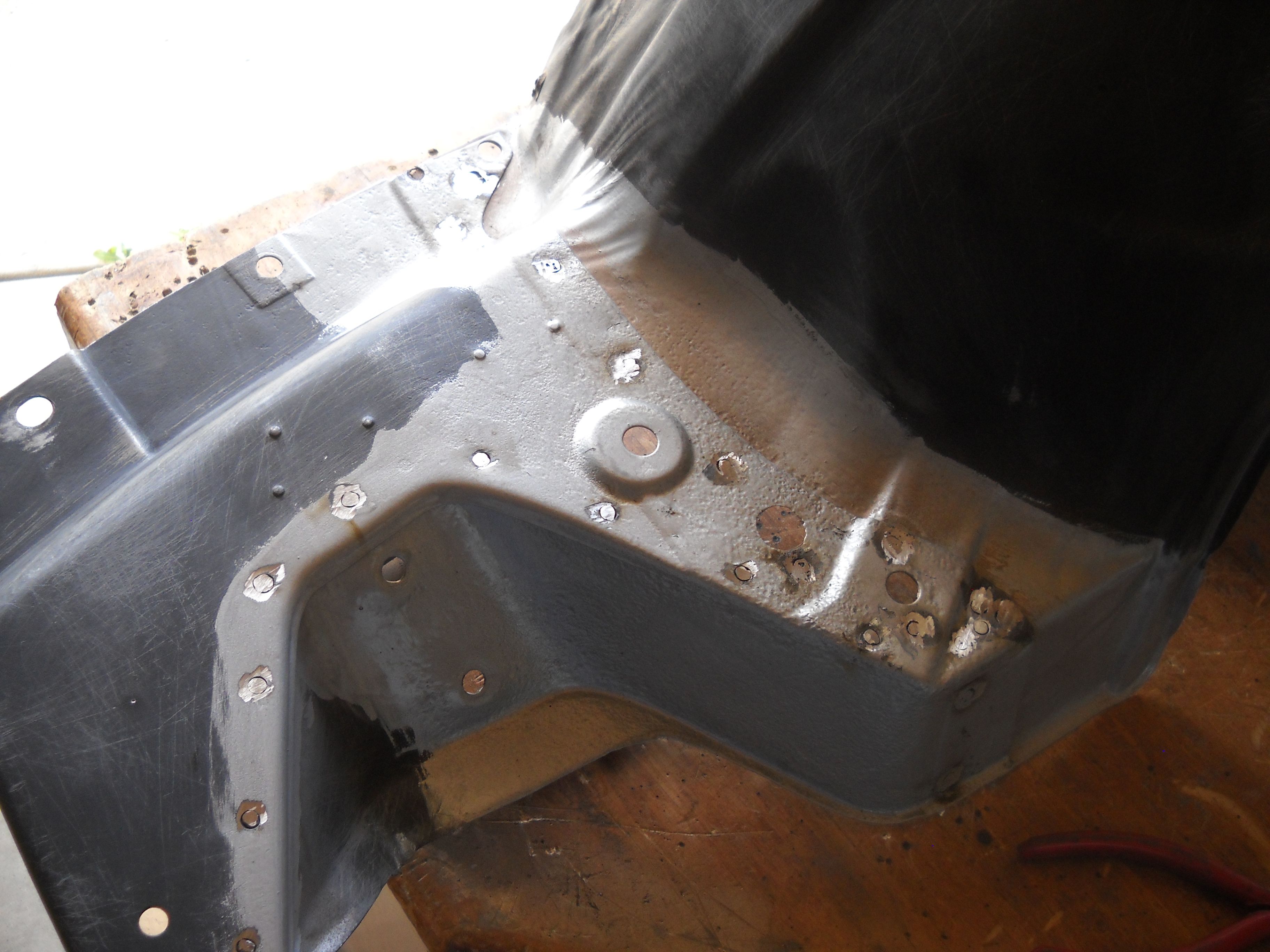

Thumbs up 7/29 Update
Had a couple hours in the garage to get the inner fender welded back to OEM without the rust!
This is what a little TLC and a couple hours can do to refurb your inner fender wells. Hopefully I can get back out in the garage later and start on the other inner ... same rust spots and it needs a patch welded in the corner.
Plug welding with a copper backing!
Ditto
Much better than before
Still need to finish welding some of the holes and then touch up with POR over the welds and she'll be done .... one down one to go
Thanks for looking...

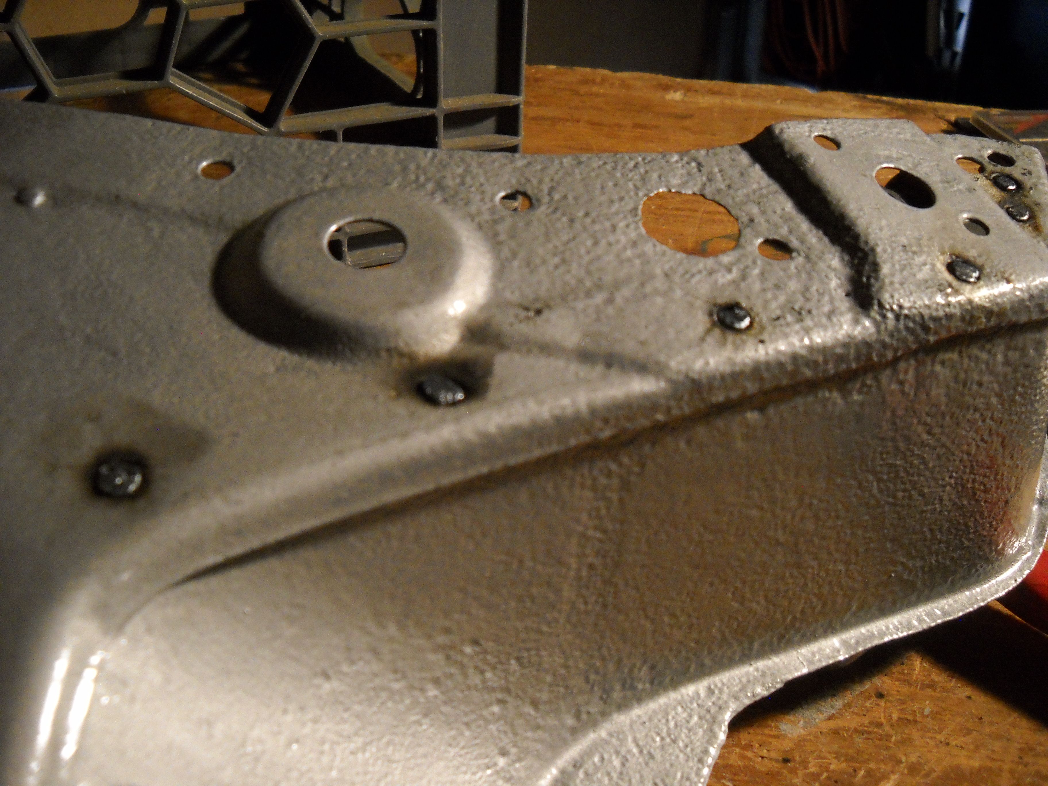

I hate to be the bearer of bad news, but it's better to say something now before you get into structural parts of the car, your welds do not look good
It's hard to tell without being there in person, but the welds either look as if you do not have enough wire speed, not enough gas or the metal isn't cleaned well enough. Also, you ground too much metal away when you ground down the welds. On the photo of the ground welds, you can see you did not get penetration into the surrounding metal. It doesn't look as if you are using the proper technique for rosette welds, as well as the what I mentioned above.

I see what you are looking at with the welds ... the first pix is the only one with rosette welds! The last two are the back of the plug welds (with a copper backer) to fill in the drilled holes when I removed the panel from the other panel .... make sense? I then welded to this plug from the top panel.
I assure you I will finish the back of the plug welds with some heat before I call it done.

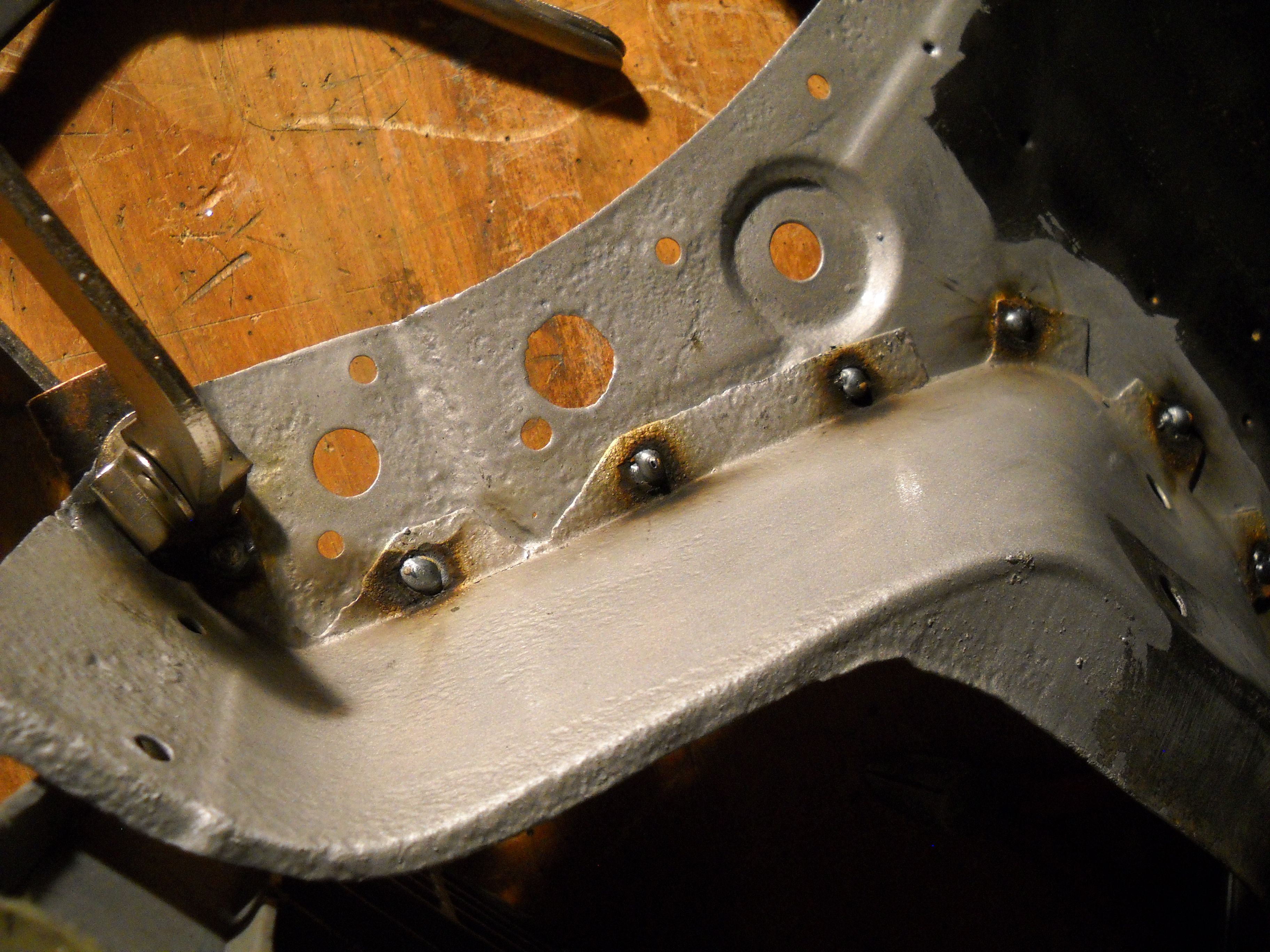

Default Clarification
Maybe I should not have posted a between shot of the inners .... but that was good that Jeremy said my welds look like sh$t, that means a lot to me THANKS
Started with a 1/4" hole (drill bit size) undercut the welds and put a 3/8" rosette weld on the top and finished the welds, looks like this now
