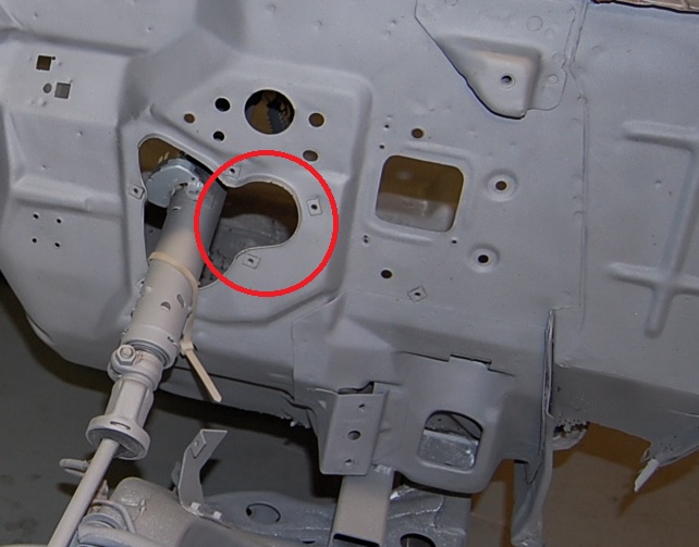

Looks like the 70 is the same. Bracket will fit 68-72 with a little bit of work.
You will have to trim the steering column mount plate opening on the firewall to have the bracket fit flush.
I'll have to get a 70 clutch pedal to verify the ratios.
70 top
69 bottom

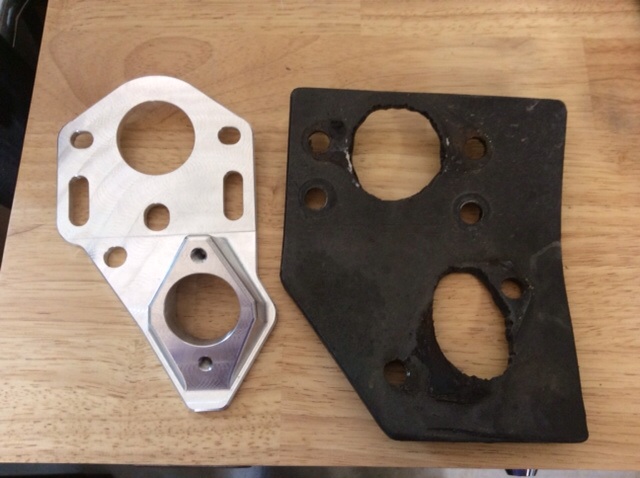

Posts: 8
This is a comparison of the bracket I made 14 years ago before all these cool parts were available and the new one from meanstreet performance. The new bracket will look much better!
Glad you like it
